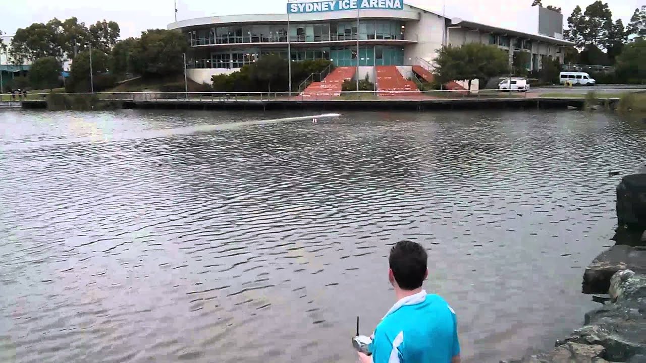

                  • Aaron Johnson
                    • 49
                    Here is a quick video of the maiden run, I am really stoked with how well this thing goes. The electronics barely get hotter than the ambient temp outside which is great!
                    • flraptor07
                      • Aug 2013
                      • 2451
                      That boat looks like it runs pretty nice, time to jump it up to 6s and find a much bigger pond!

                        • Aaron Johnson
                          • 49
                          Originally posted by cugino View Post
                          Really? It works? I wouldnt ever beleive that.
                          Who knows mate, 35 degrees Celsius here in Sydney today. I went three battery cycles one after another, she was pretty much running constantly for 60 minutes and esc and motors didn't exceed 50 degrees.
                          The only problem i have is a small amount of water coming up the reverse spinning shaft.
