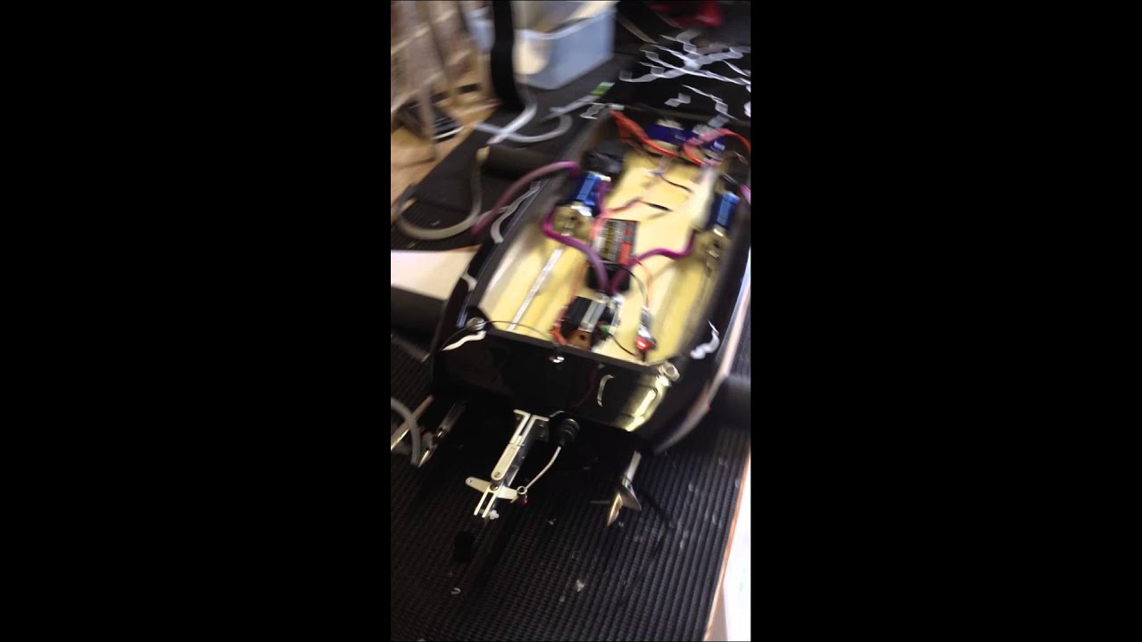

              Thought I would bench test the electronics!

                just checking out your build you sure that water pickup is going to work i would think it would not due to being placed in the center of the hull cat hulls ride on the sponsons. i placed two of these in my twin neu AM avenger cat on the bottom rear of each sponsons. I could be wrong im no expert boat builder. maybe someone else would have some more feedback on this

                  I think you have a fair point to be honest! Although it will likely run pretty wet and as I have placed it towards the back of the boat and it would certainly pickup water at slow speed. Under load and when she is up on plane you might in fact be very correct. I'll monitor temps and see how we go. Worst case I will run a rudder with dual water pick ups to compensate.

                    I have to agree, I don't think your going to get any water flow. If you test like this, make sure you have water coming out on your first pass. If you don't I would bring it in
                    I run basically the same hull with a single rudder pickup split to each ESC and motor and run cool. I'm using 60A AQ ESC to 36mm 2300Kv spinning x442 props in the lower 50mph range.

                      I wouldn't even risk it, you're not going to get any water flow where you have the pickup located now. Move it to the bottom of one of the sponsons or get two singles and put one in each sponson. I'd hate to see you burn up some motors and ESCs.

                        Well I risked it and they suck up water just fine, what a great boat so very happy with it!

                            Water pickups in the tunnel not going to work , they need to be in the sponsons and they also need some work with a file or dremel to make them work you need to lenghten the hole in there good luck
