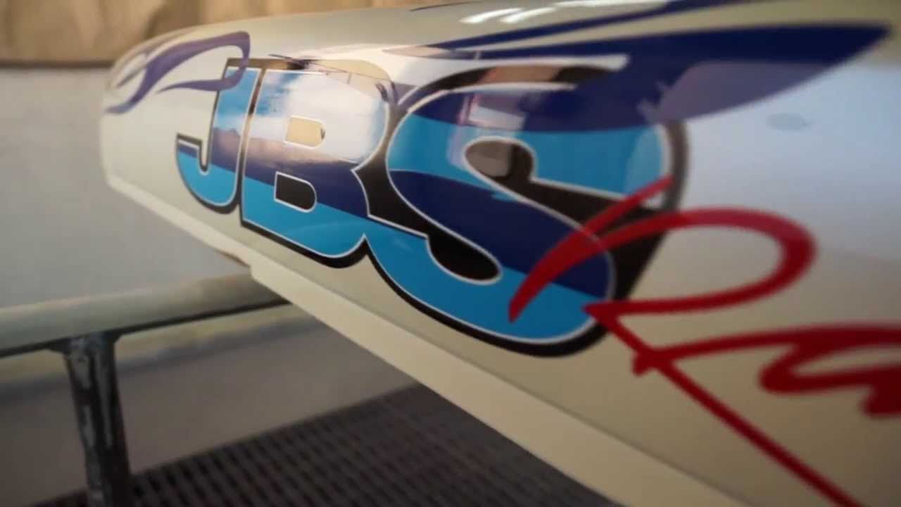

    painting goes on....last time we have stopped at applying primer coat. In the mean time...two layers of pearl white mettalic paint were applyed, dried and sanded again...everything was prepared for JBS decals.
    As I do not like JBS original design with lots of blue areas at the back of the boat and I wanted to show as much as I can the beauuuuuutifuuuuul white pearl paint, I have modified the original decal set ...a bit. I wanted basically white boat....with some stickers applyed...not too much
    After decals were set...the boat is prepared for two layers of clear coating
    Photos after first layer of clear coat over the stickers
