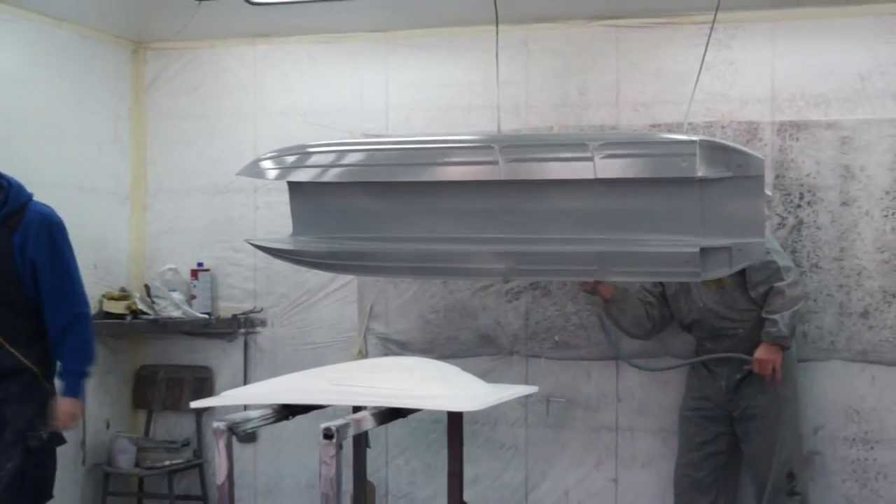

            Painting...MHZ Mystic 1850...
            On the photos is Mario, a professional car painter...he worked for years for Nissan service center
            VIDEO OF PAINTING SESSION IS COMING SOON
            Sanding of the whole hull took almost two hours...

              Production mistakes are fixed with putty, dried and sanded again...

                In a ventilated and heated painting chamber...
                Ready for two layers of PRIMER coat, with corrections between layers
                Primer coat applyed...

                  With primer coating applyed...
