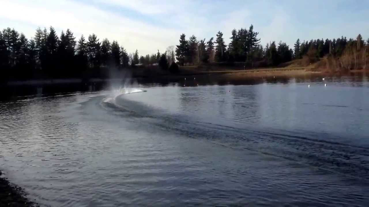

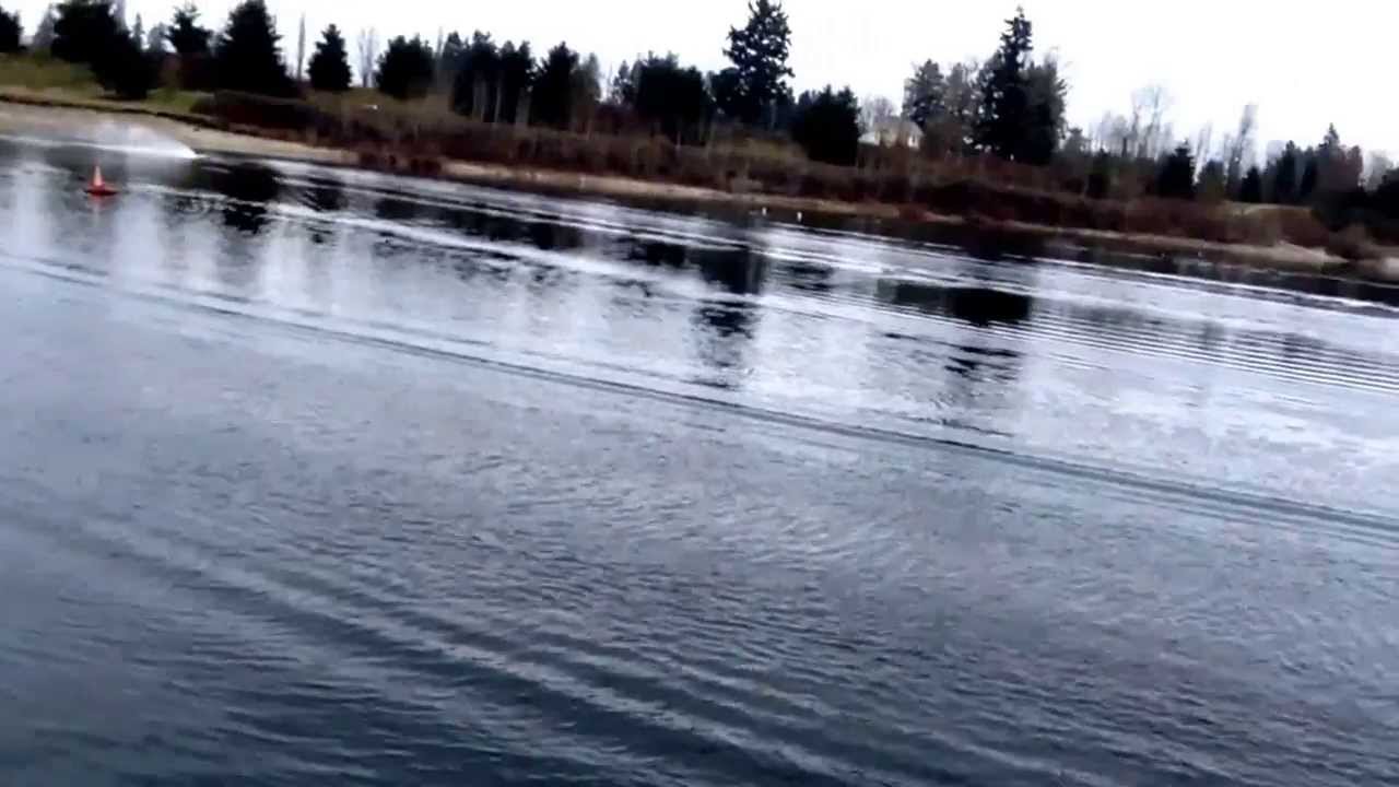

The "Bling Rocket" build
That's what I said before, around 40 mph mark. Looks good except the bounching, did you move your batts. up a little to see if that helps?
I think you need a bigger pond now.
Looks to be running a little better and a lot nicer vid to.

That must have been fun to do,
It does look like it's getting a little squirrely at the top end.
I was waiting for you to say that,
That is what I did with mine when it was riding a little to loose for my liking.

I'm no expert obviously, but I have to say the second pass was where you got your 41 mph reading from. I'd try to move your batts. a little bit forward. I found the sweet spot 1.5 to 2. inches forward from where they were originally places and I really like how smooth she cuts through the water. Give it a try and see how you like it, if not, reset them back and tune the trim tabs
This info is just my 2 cents worth of experiance.
Great, looks pretty good. I hope to get out soon. Any speed #'s,.looks like somewhere in the low 40's.
