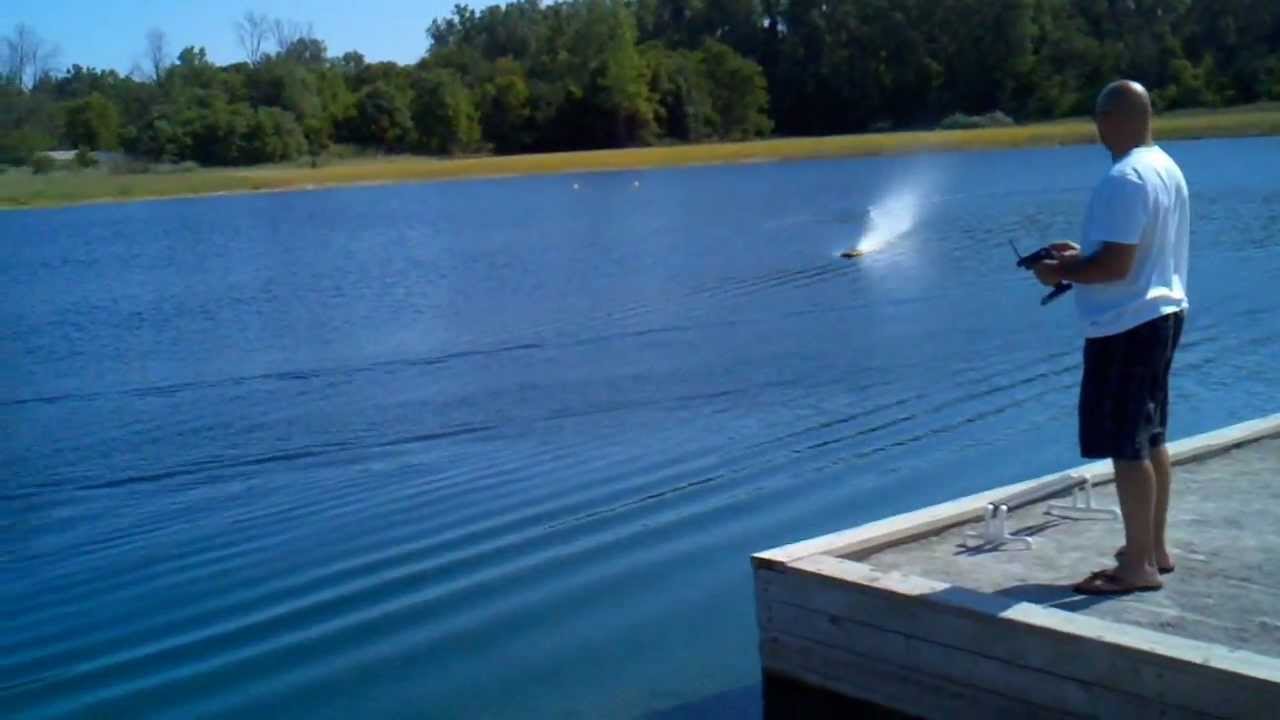

            Here is a short vid, sorry about the quaility. My phone usully takes pretty good videos, but I think the low light was messing with it. That combined with a shaky camera woman....

                      Fixed her up and ran again tonight with a 40mm prop just to make sure everything is working ok. Ran alright, but still some porpoising. CG now at 35% and still cannot shake that slight bounce. Have new props on the way, some different sizes. Will play with the strut angle some more also.
                      Here is the video of tonight's run, nothing special and definitely not braking any speed records...

                        Final setup....w/ CNC x443

                          Try offset rudder, works with the Geiko boats

                              Maybe try some adjustable trim tabs on the transom.
                              At least you'll have something easy to work with, rather than complicated propellers.
