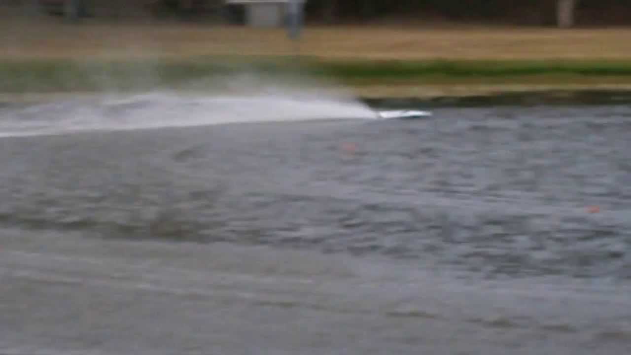

                          Flraptor07.
                          You were right. I do love it.
                          The first run was very wet I had to get the battery right back to the motor where the ESC should be & it was still nose heavy. But with a bit of positive strut adjustment & raising the tabs & turn fins it lifted the nose & got some air under it. I don't know what the weight of a 6s pack will do. We'll see in the new year.
                          My hull does have a slight hook in the last 6" or so of the hull but at least it's even on both sides. Does anyone else have the same?
                          I found it to be extremely stable in the turns at full noise, on our tight little track at Boondall. Should be great on our race track at Lakeside Raceway.
                          So here's a couple of pics & A video of the latest addition to the Wet Track Racing fleet on its third run yesterday.
                          Cheers.
                          Paul.
