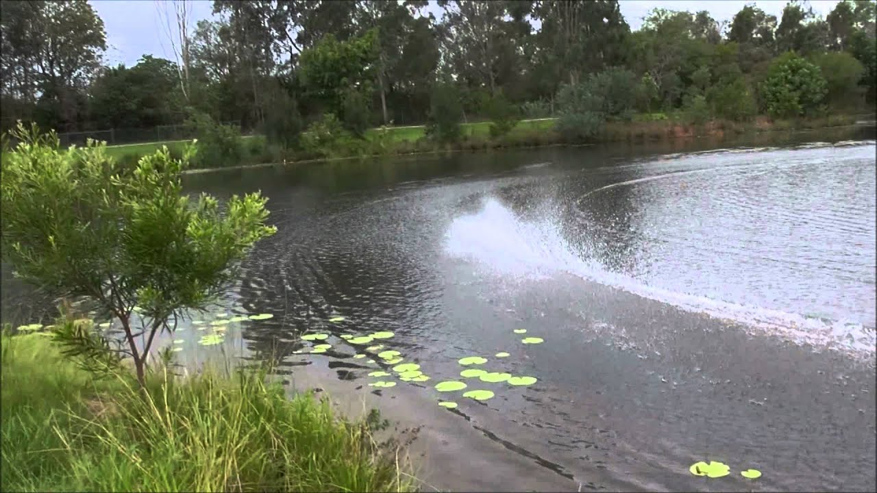

                            This shows the glass work I did on this one, I also made a turn for it which seems to be ok, we will continue to tune it and get after it a bit. Once the owner / driver gets used to the new set up and starts to drive it hard.
                            This is the first run with the new pictured set up and added glass work, prop snB m445.

                              Tristan.
                              The poor thing never got to go in a straight line. But it did prove that your turn fin works.
                              You've got to find a bigger lake.
                              The guys at Sippy Downs have a big area for fast electrics. It is officially known as the "Sunshine Coast Model Boat Club"
                              All model boat enthusiasts and visitors are welcome to join us at our sailing venue at the University of Sunshine Coast, 90 Sippy Downs Drive, Sippy Downs, QLD, 4556.
                              We are racing at Lakeside this weekend, but a few of us will be up the Coast the next Sunday if you want to come along for a bit of a run.
                              Paul.
                                • 7512
                                #870
                                Nice, but you need a BIGGER pond......
