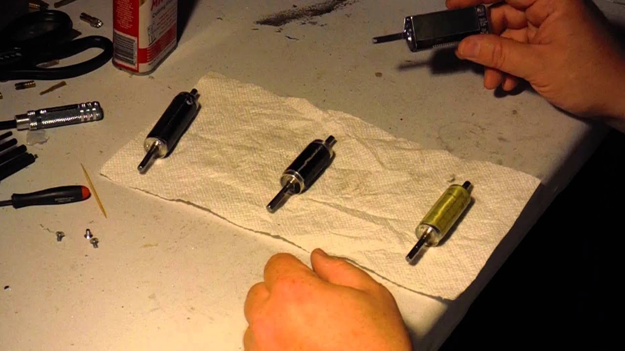

                            I rotated the end bell. I prick-punched the center of each hole location. I then #1 center drilled (only the tip portion!), tap drill 3/32" and then I tapped on location. Using Tap Magic for Aluminum no threads pulled and it all cut like warm butter!
                            Of course CorrosionX was applied twice to ensure coverage.
                            I then slid some silicone tubing down on the wires to make a grommet. Shes back together better than factory new!

                              Sorry love video's.

                                Thank you for the video. Nice demonstration.
                                Actually the wrap has two layers, if you cut the black carbon fiber outside, you can see the yellow Kevlar inside.
