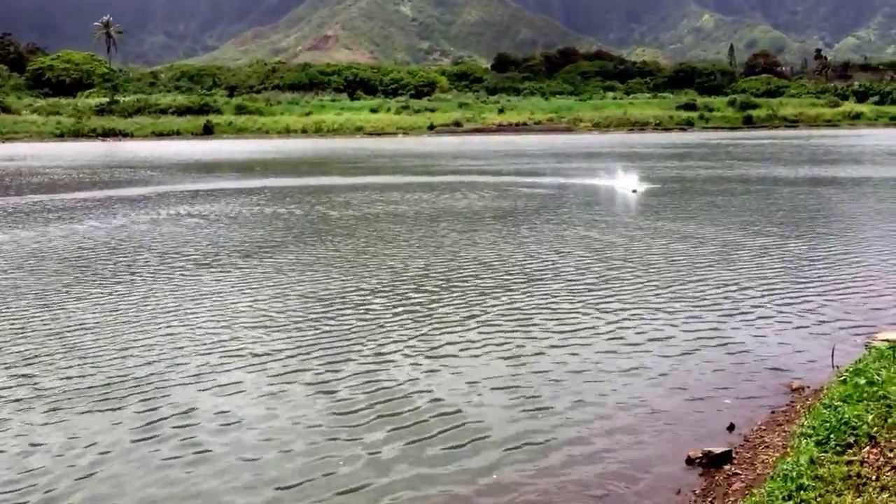

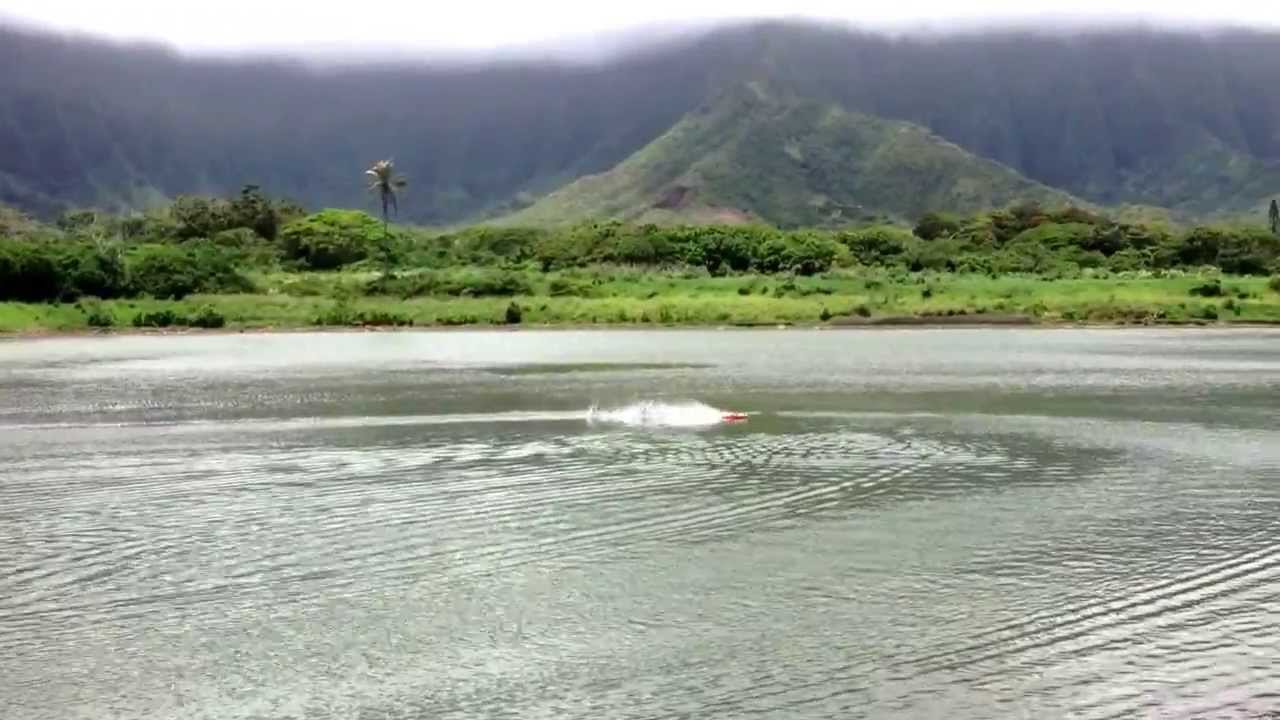

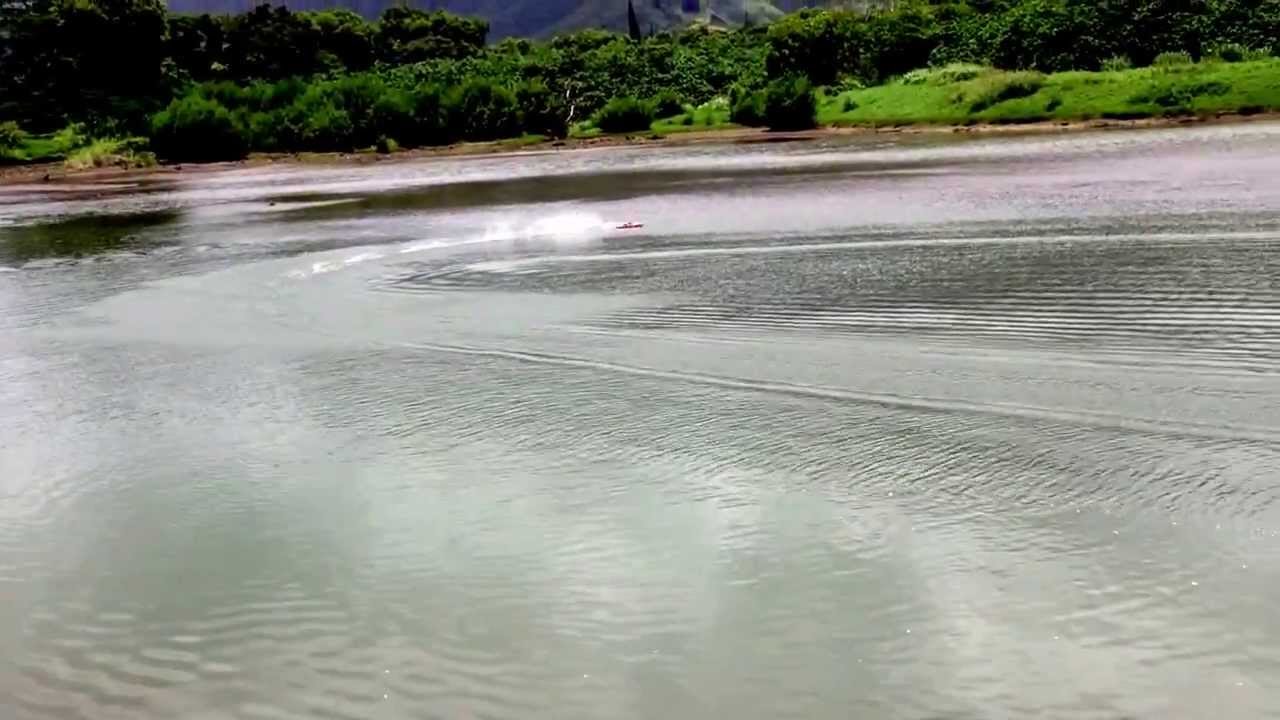

          we ran Tunda's boat today, testing props as my boat is getting the wire drive treatment at the moment. this run was with the stock prop that came with the boat. the prop that came with my boat is clearly marked 438, Tunda's had no markings what so ever, none the less its the prop that came with HIS boat.
          this one was with a 40mm prop
          he ran about 8 laps before i realized that i wasn't filming this run was with a 45mm prop. and here is the gps of the laps before this.
          we did a total of about 15-20 laps using one 4s 5000 turnigy battery pack started with the stock prop and moved up from there. motor and esc never got more than warm after 8, well almost 9 laps, with a 45mm prop! more to come soon.

            #80
            Like I said in an earlier post. Those TFL motors are efficient, strong cool running motors. An M447 doesn't get that motor more than warm either.
            As you discovered, you need to move the COG forward a bit as the speed increases. Did the battery tray stay attached to the hull during the flip?
            I notice you can't take the turns at full noise. It's starting to skip even as reduced speed.. What are your thoughts on the turn fin?
            But it is a fun boat though. Eh!!
                yeah, we talked about moving the battery back after running with the stock prop, but thought we'd leave it to see how she handles with a bit more prop. He got about 8 good hard running laps with the 45 and it only got loose once on the end of the back straight away, but getting off the throttle settled it down. battery try stayed put. im gonna add some epoxy to mine, as one side barely has any glue. im not sure about the skipping in the turns and the turn fin. i guess i doesn't bother me too much as long as it holds speed through the turns, though id like to get the turn fin a bit more perpendicular to the flat of the vee of that side. i think that would fix it. maybe someone will jump in and give advice. its a nice running boat, runs right about at the 50mph, (which is what we were looking for), motor/esc temps are a total non-issue, and so far the inside was completely dry. we are both super stoked!!

                  I think you need to move the battery forward a bit. Just to keep the nose from lifting. I find that mine works best with the front of the battery level with the front of the tray.
                  I'v tried the fin perpendicular with the bottom of the boat & in my opinion it was worse.
                  I like to have my boats able to take the turns at full noise. If I can't, I consider the boat not set up properly. Backing off for a turn in a race can get you from 1st to 3rd in half a lap. I know you are not racing, but the principal is the same. Fast straights & fast carving turns.
                  I have to agree with you though It is a great boat for the money.
                  Although at this point, I don't think IRON-PAWW would agree.

                                #90
                                Tunda.
                                The unstable turns seems to be common to these stepped, shallow V hulls from the videos I've seen of European & Asian racing. But the barge board fin seems to be the best at keeping them somewhat more settled. I'll try one this weekend if I get the time to make one up. I've got a few boats to get ready for a race meeting on Sunday. Unfortunately they all need a bit of attention in some way or another.
