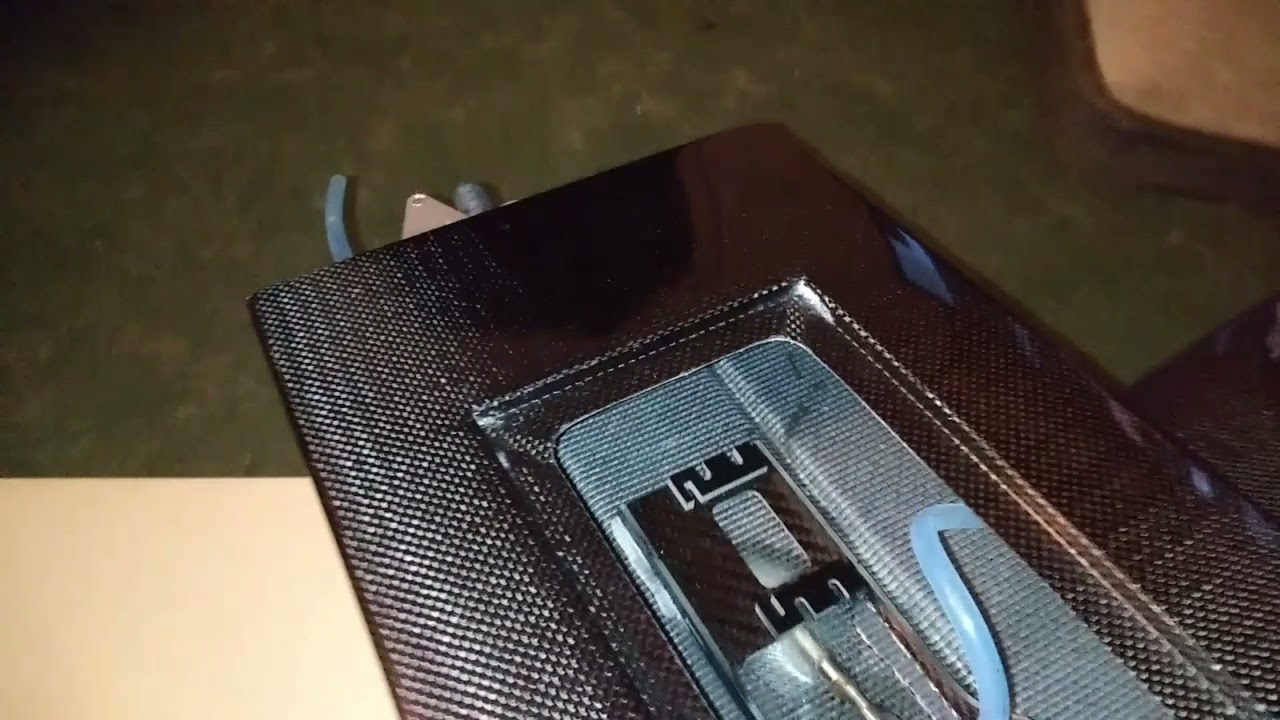

    TFL Popeye Carbon Fiber
    Check out Big Daddy's video on one of my custom TFL boat builds. Show him some love for supporting me guys! Watch, like, comment, share and subscribe to his channel

      Looks great!!!
      Ditch the cooling on the motor mount. The fitting there are quite restrictive.

        Thanks for watching man, I understand what you are saying but I have had different results after a lot of testing. The motor cooling mounts consistently keep the overall temp of the motor down without any significant increase in the temperature readings on the ESC.

              Did you measure flow rates? You only have so much pressure, and the flow rate is THE mechanism to remove heat.
              The larger the flow rate, the smaller your delta Temp will be on the water for the same power input

                Like I said before I understand the basic point you are making, obviously more water flow will provide more cooling. You can disagree but I just go by results I have personally had testing in the water and this setup certainly helps me keep a more even temperature on the motor overall after running 6 laps. Some people like adding a lot of independent water intakes or running oversized lines and such as you seem to prefer, others run lower Kv motors, smaller props, cooling plates or a combination of all of these. At the end of the day we all work towards the same results just have different ways to go about it. Thanks for the input bud you are definitely not wrong in the point you are making but in this situation assuming the mount is a hindrance is just something I cannot agree with

                        I just significantly increased my water flow with a new rudder and temps went up, actually.
