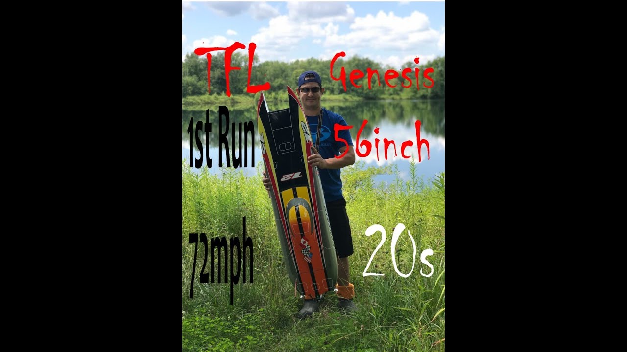

    Very sweet boat & great maiden, congratulations! I loved the reveal in the beginning. You can tell there's way more speed to tap into. Phenomenal boat, should be crazy on 24 cells...

      Thanks man I appreciate that, def taking my time on this one. Very impressed with the performance on 20, will prob run a few packs through before I go up to 24. The kvs are a bit high for 24 imho, she got 5684 1000kv
        • 4335
        Just so we're clear, when classifying a boat's setup voltage, you refer to the number of cells connected to a single motor. If the boat has 7 motors each with 10S, you have a 10S boat, not 70S. If you have two 10S packs connected to a single motor, that's a 10S2P setup.
        Looks like a good start. That boat needs a bigger lake to stretch it legs for sure.

          Thank you for this info. I didn't know that and I like getting it right. So this is a 12s boat...
