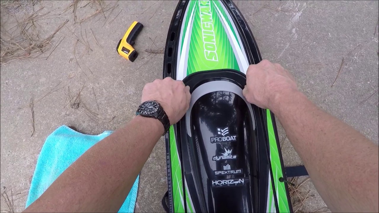

    First run on My new Pro Boat "Sonicwake" 36 self righting boat. The gps logger got 64mph and the gps devices got it at 63mph. This run was right out of the box except for a prop swap. https://www.youtube.com/watch?v=JEZs9EmC5P0&t=14s

                  Thanks! I went over all bolts and screws and I added Loctite where needed and found the rudder mounting screws were a little loose. I took the strut bushing out and sanded a little on it so it would spin free and put a cable saver on the flex shaft. I did add a few drops of 3 in 1 oil on the hatch bolts and ran them in a couple of times to get the threads broken in and that's about it. Good luck with yours.
