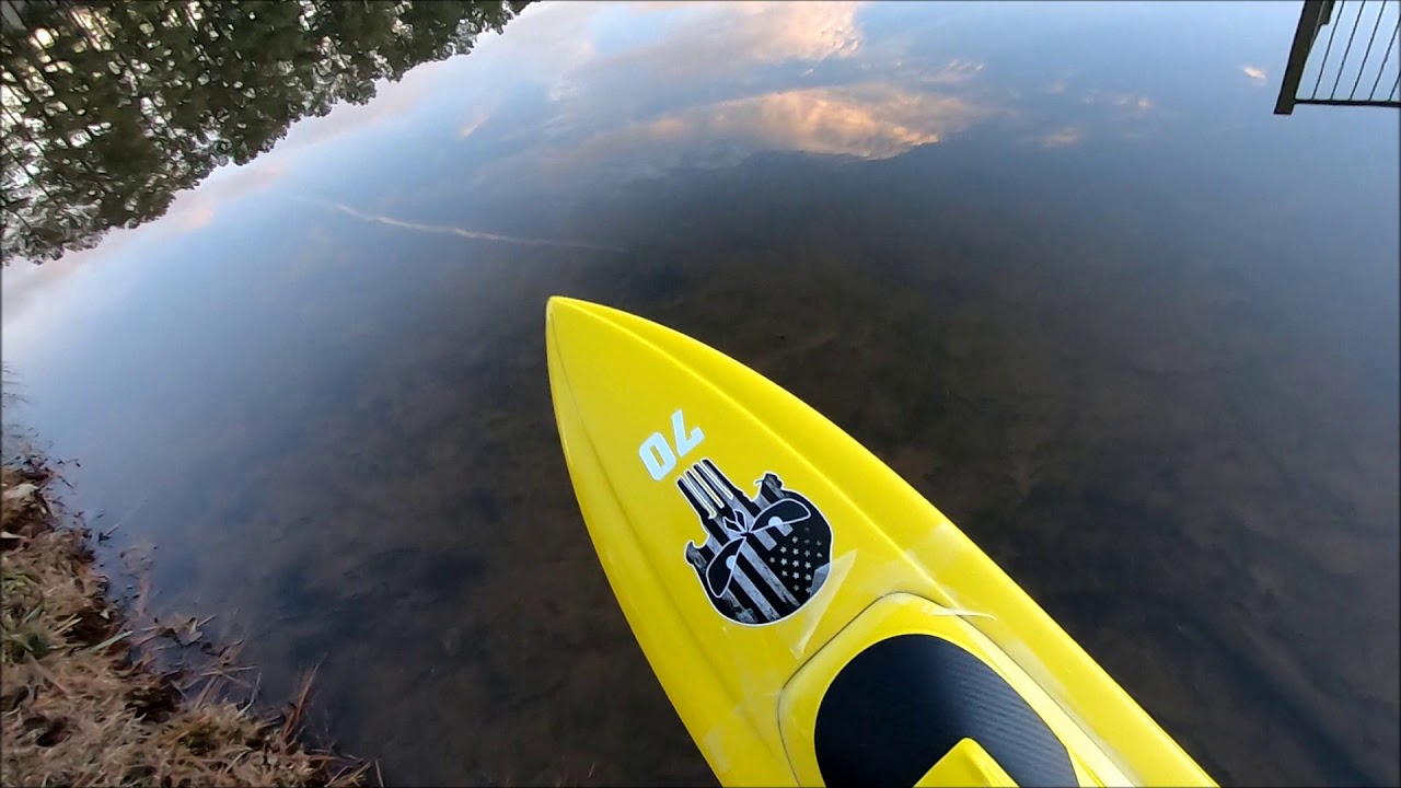

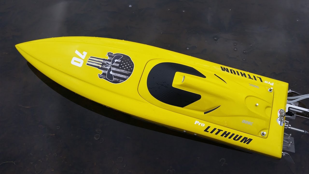

          Pursuit hits 74mph on 6s!!!
          Here is another quick run of my Pursuit 74mph was the top speed on this one.

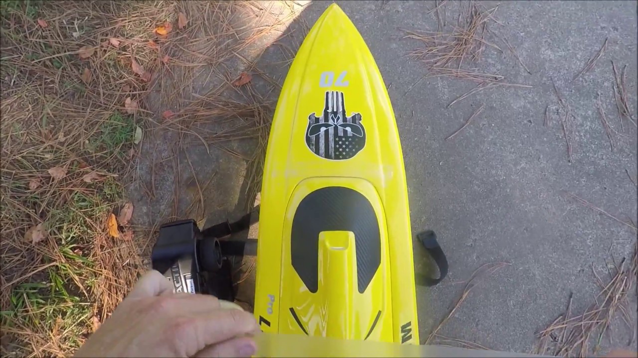

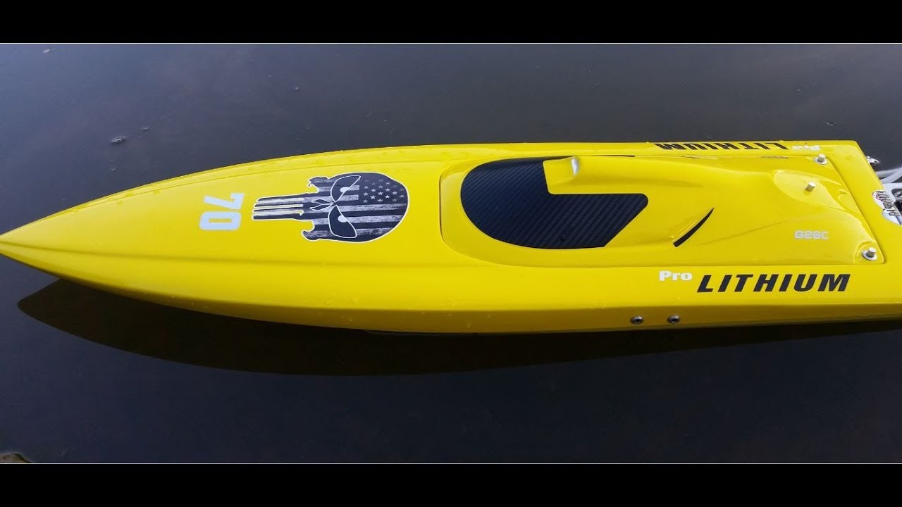

            TFL Pursuit hits 76mph on 6s.
            It was too windy and I probably shouldn't have been trying to run on the extreme edge with this boat, but I ran it anyways and I got a new personal best speed of 76mph by the data logger and 75mph by the GPS device. I ran the boat yesterday and got 74.7mph but this run tops that one so I won't be uploading that run. At this speed the boat needs almost glass water or it can get upset pretty quick. It handles very well in the 65mph range on any waters but when you get over 70mph is when it gets dicey. The temps were 115° motor and 123° on the ESC on this run.

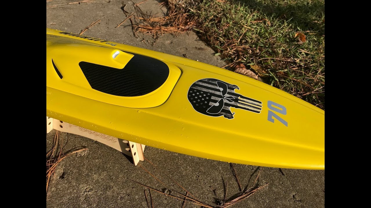

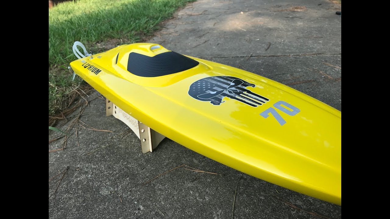

                    World's fastest 6s TFL Pursuit 79mph!
                    True for True this is the World's Fastest 6s TFL Pursuit as of 11/16/18 (with no edits or cuts in the video). The boat got 79mph by the data logger and 78mph by the GPS device. The first" teaser pass" leading into the start of the video was my run right before this one and the max speed from the data logger on that run was 78mph and the gps was 77.2mph.
