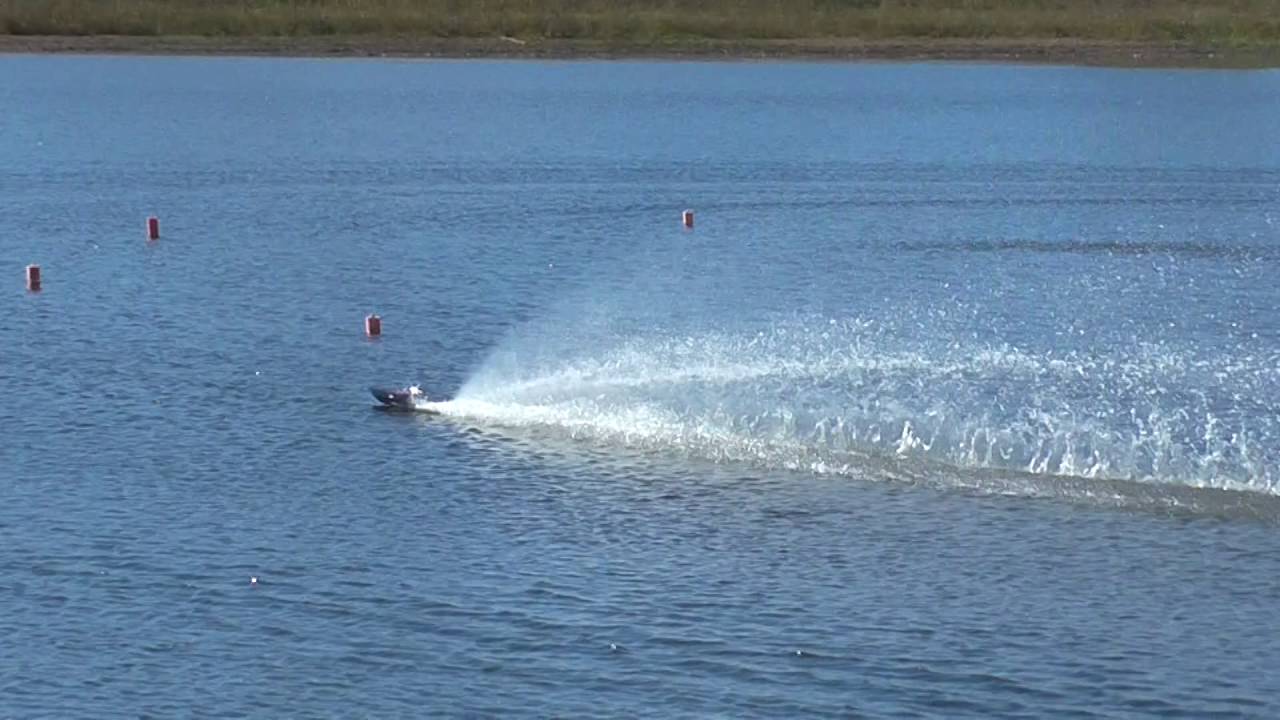

That looks really good !.NAMBA20...Caterpillar UL-1, P-Spec OM29, P-Mono DF33, P-Spec JAE, Aussie 33" Hydro-LSH, Sprintcat CC2028 on 8s, PT SS45 Q Hydro, PS295 UL-1 power, OSE Brothers Outlaw QMono 4-sale, Rio 51z CC2028 on 8s
Thanks Todd.
She sits pretty well for its first big test run. A bit wet in the corners. But we'll get that sorted.See the danger. THEN DO IT ANYWAY!!!
Thanks guys.
Race water will be a different prospect though.See the danger. THEN DO IT ANYWAY!!!
Very consistent..don't think its wet in the corners...congrats GillGO FAST AND TURN RIGHT !
www.grsboats.com.br
Could be perfect in race water.NAMBA20...Caterpillar UL-1, P-Spec OM29, P-Mono DF33, P-Spec JAE, Aussie 33" Hydro-LSH, Sprintcat CC2028 on 8s, PT SS45 Q Hydro, PS295 UL-1 power, OSE Brothers Outlaw QMono 4-sale, Rio 51z CC2028 on 8s

I hope you are right Todd. The deeper V might cut through the chop better than the shallower V hulls.Originally posted by Brushless55 View PostCould be perfect in race water

It just seems to drop the nose a bit & slow down in the turns.
I have a 160mm rudder blade on it that has had 25mm cut off it. I think I might take another 6mm off it for the next run.See the danger. THEN DO IT ANYWAY!!!
