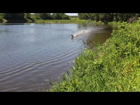

            Hi went running the boat again, everything was fine! Here is the first complete run:

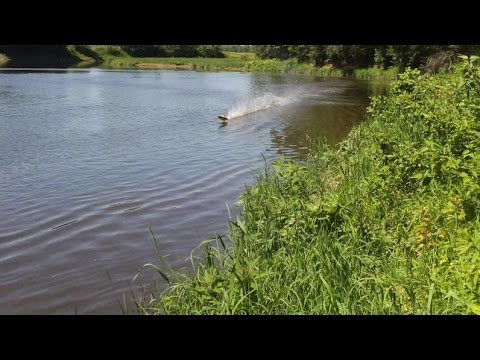

              Here is the second run:

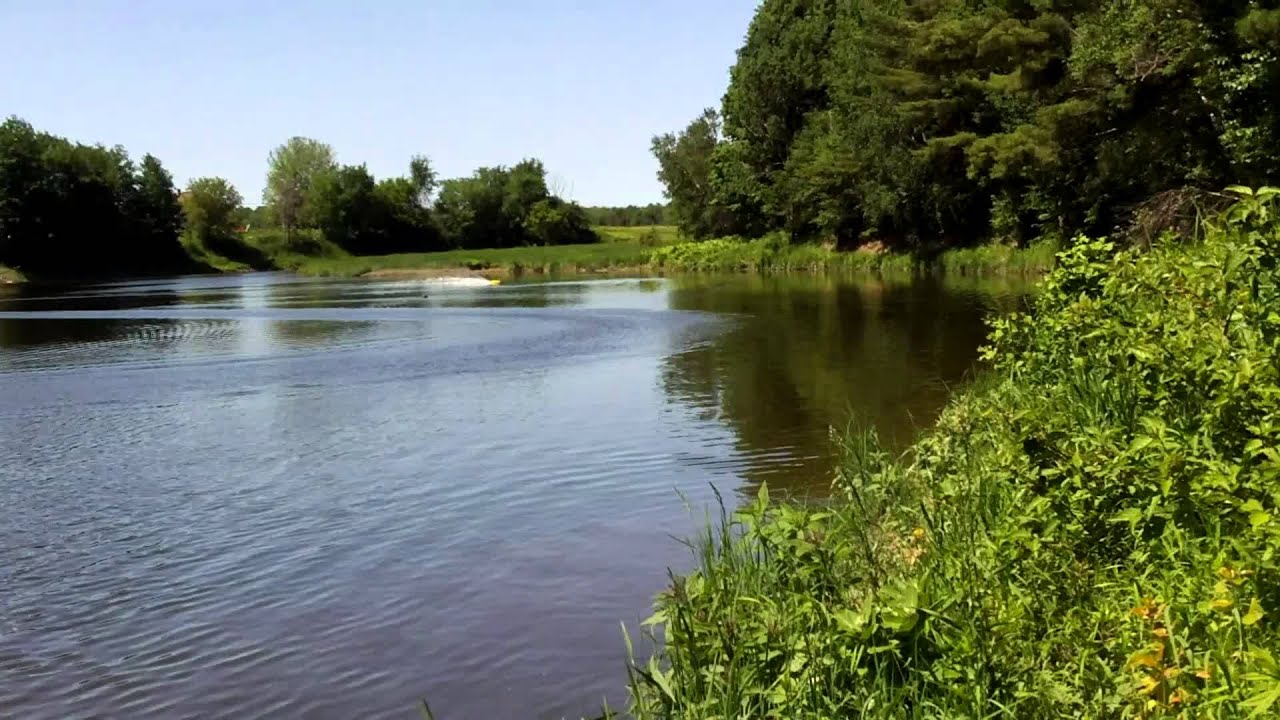

                  And here is my last run of the day:
                  I wasn't able to go WOT on the first pass.
                  • martin
                    • 2881
                    With the front of the boat coming up like it is it looks like you have to much positive angle on the stinger ( angled up to much prop end ) or the centre of gravity is to far back.
