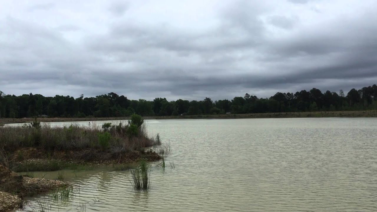

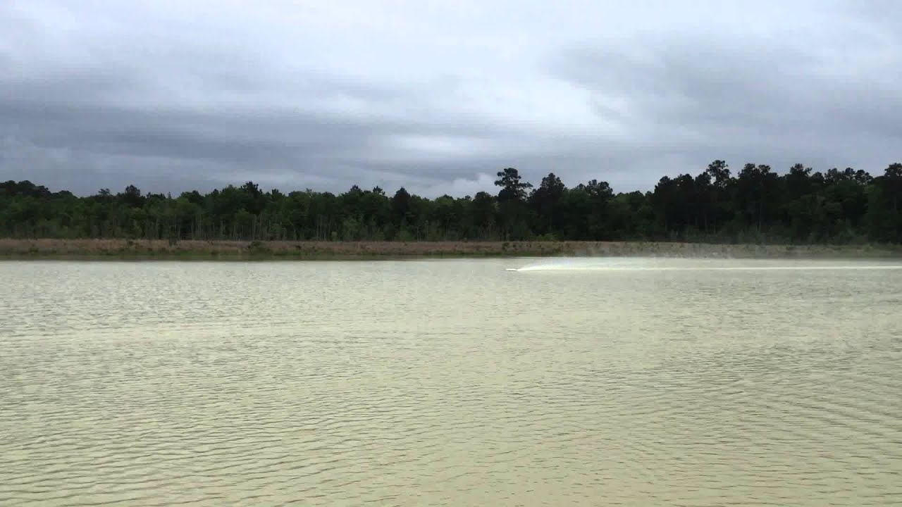

    This I think deserved its own thread. Backstory: I've been building cats for a little while and I decided I wanted a boat that could be run in water that's not glass smooth. I decided to build a mono. I figured 32-34" would be good enough for what I run in. I had initially thought I'd build a 70mph saw mono and then back it down to 50ish for running on the river and when we go to Panama City for vacation....we always take a pontoon boat out in the bay. Thought that might be fun. Well.....I always get carried away with things and decided to see just how fast I could make a mono go. Reliably. Well here's where I'm at so far....

                Thanks guys. Honestly I think I'm about done. I don't want to push my luck. I am getting Dasboata to do me up a prop and maybe I'll get 93 or so but that's about all I think I'm gonna push it. I'd like to hit 100 but that extra 10mph ain't gonna be easy. I did this today in windy conditions but oddly the water was quite tame. In a little chop it goes faster. I like the fact that I don't have to pay much attention to water and wind conditions to go fast with this boat. My cats, if it's a little windy...forget it. Good stuff! I'm starting to like monos!

                      Here's a backup pass right after. I'm not about a one pass wonder lol
