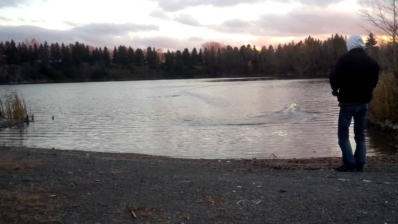

    Hi, this the first runs of my Pursuit!
    First vid is on 3s with stock 1620kv motor and MM2 ESC.

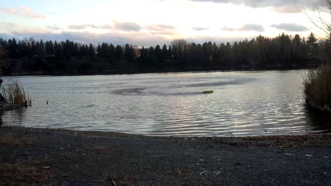

    second vid, same setup, but on 4s1p.

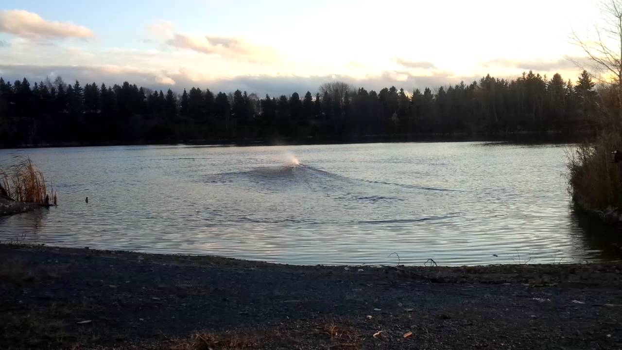

      Third vid, same thing on 4s (2x2s in serie).
      I will put my 2400 kv in for the next run!

        Glad you finally got to run her.......you like?
        Few observations:
        You crack me up when you put her in like you were placing baby Moses in the Nile........careful, careful!! Most of us walk up near the edge, dont stoop and throw her in..............
        The prop is not getting it up on plane very well and then loses bite in the corners, need a bit bigger, maybe try and x442 with more surface area than the super detoungued, stock prop has
        Try to make large oval type passes, you also dont need to let off of the throttle when turning, it will corner like on rails
        Cant wait to see the 2400kv!

          Thanks for the tips man! Yes, it is so stable and predictable, i love it already!
          And let me comment on your observations!!!lol!
          ''You crack me up when you put her in like you were placing baby Moses in the Nile........careful, careful!! Most of us walk up near the edge, dont stoop and throw her in..............''
          Yes, i'am carefull... after all it is my real first big boat, and where i put it in, there is only 7'' of water... so i didn't want to hit the bottom!!!
          ''The prop is not getting it up on plane very well and then loses bite in the corners, need a bit bigger, maybe try and x442 with more surface area than the super detoungued, stock prop has''
          I think i will try the stock Rio prop, it's a 42mm... And also i'll order a x442.
          ''...you also dont need to let off of the throttle when turning, it will corner like on rails''
          I still have this habit frow the Rio, at full throttle, the Rio Always wanted to spin around! I Will get more confident in my skills as i'm driving it, i hope! But yes, i've noticed that it is really good with sharp turns!
