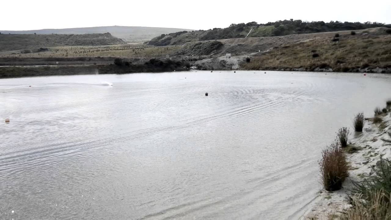

    Hi guys
    this is a video of my Delta force 33" on her maiden voyage:
    Motor : Leo 4082 1600kv
    Esc : Swordfish 200
    Prop : M445
    Batteries : 6600mah 6s Powertech
    The strut is set 7mm offset to the right and 7mm high, 0 degree strut angle. COG set at 32% from Transom.
    On this run i only managed 80% full throttle before the boat started to bounce so for the next outing the strut will be set to 0.5 degree negative to help keep the nose down.

    Nice run, that concrete wall in turn one is scarey, has anyone lost control and hit it?

      Thanks, yes only one person has hit it and it was really not pretty. When we race the buoys are repositioned to allow more room in turn one and two, in the vid the buoys are 15m from the concrete wall...
