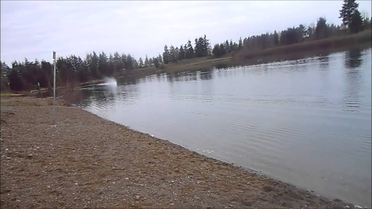

                            Awesome! You need a longer area to run in!
                            Like this Travis:
                            116mph. And never mind why it took flight at the end (pm for detail )
