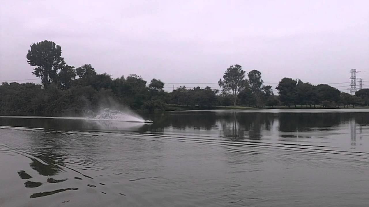

    Cheetah with TP Power 4060 2040KV on 4S2P
    Swapped out the Neu 1521 1.5D , propped down from a 452/2 to a 447/3, boat ripped pretty good !

    Nice tony its looking good!

          I weaned myself off the GPS Truth-O-Meter some time ago. I now use the Thrill-O-Meter. When applied to the Cheetah it reads : "Zippity-Doo-Dah"
          (best guess : 60 mph, or close)
