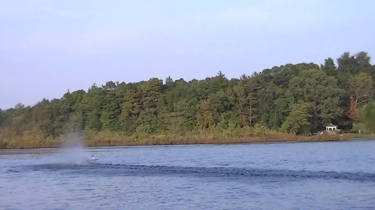

Testing Pursuit with a 4074 1800kv 180a ecs and turtle modded x447/3 on 6s1p 55.8 mph
    Thanks Dale.
    This last video hear is a turd but I had to share how strong the hull is and the story,
    I was just watching that nice real boat running around the lake.
    And you could hear the prop hitting all the old tree,
    Because the water is only three to four feet deep in most spot of it.
    So my eyes where not on my boat all of the time.
    And yes please do post some video's when you can.

                  New short video on a turnigy 6s 40c 5000mah pack and same setup,
                  And temps are below 100f on a full 5minute run.
