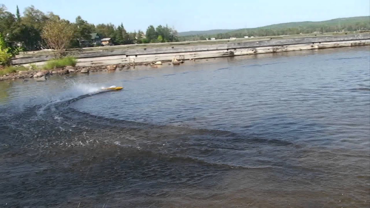

This is a Micro HydroMite that I built from Doug Forrester's plans.
16" Micro Hydroplane
Tacon 2848-3900kv inrunner brushless motor
SeaKing 35a brushless ESC
Octura .98 flex shaft with 1/8" stub shaft
Octura x430 prop
GensAce 2s 1550 25c or 2s 2200 25c battery
OffShore Electric Micro Hardware System strut and rudder
Octura x430 prop
. Shot in close with extreme telephoto so you can actually see the boat instead of a little dot zooming around. That makes it look fast not speeded up like everyone thinks. Sorry, video is not speeded up. Top speed is 47kph with GPS.
