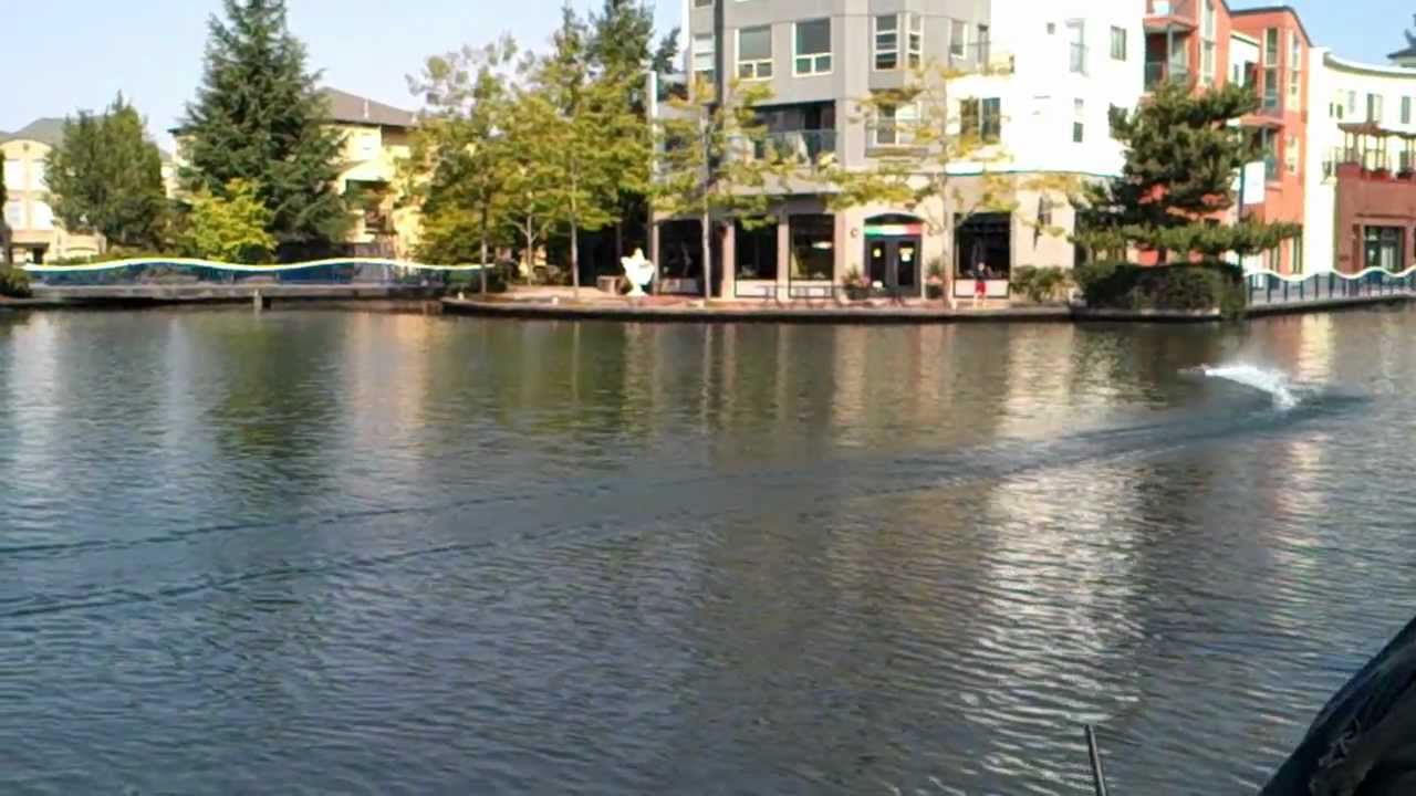

    Well I finally have recieved the new esc yesturday. Got all the new 5.5 connections done. Running a m445 prop done by dasboata. I also tested the grim 42x55 but found the 445 to be much faster. Heres a video of today, with the m445, 2s2p 5000 45-90c nanotechs i ran an average of 47. I was hoping to hit 50, im not sure if i need the strut up more but rides really nice. Right now it is about 2mm angled up from flat with the sponsons. But I will say it is a huge improvement over stock which i could only get 40-42. I never did run the m445 on the boat before I switched out the esc though. Anybody have an idea or tell me where they have there strut at.
    The second video is much better with the m445

    Put your strut up 1/8 above sponsons, and level. Get back to me with results

      Ok Ill try that
