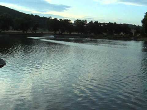

    Hi,
    this is one of first runs of my new project. Just for bashing.
    Very low cost boat.

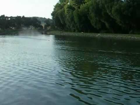

    And there is second try:

    Whats the hull and whats the outrunner?
    • cugino
      • 141
      There is some technical info:
      Hull: "Orange Cat" Carbon-Aramid 930mm
      Motors: 2x Turnigy XK3665 2100KV
      Regler: Turnigy Marine T180 2-6S
      Aku: 6S NanoTech 5000mAh 45-90C
      Servo: Bluebird BMS-760DMG LowProfile
      RX: Graupner SMC19-DS SPCM
      Prop: Alu X937 (Octura X442 next time)
      HW: All China

            Your are getting a butt load of RPM mid to upper range (too much actually) but little speed increase. Wrong props with 937. Neat to hear them scream though. What size are those wiredrives? 062 or 078?
            www.rcraceboat.com
            jwohlt5362@yahoo.com
            • cugino
              • 141
              Thank you for your advice Jeff.
              Its 078 wiredrive. I think its enough.
              What prop should i use next time? I dont like X442 Octuras. Quality is poor. Quite big difference in weight L/R.
              Should i try ABC 1616/3 ?
