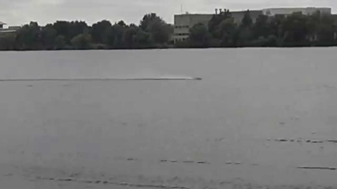

    Whiplash 21 by OSE
    Having some fun testing this Whip 21.

    nice steven...what prop did u use there?

      Nice run, plenty of torque, what's the motor setup?

        Whiplash 21 built by Dr. Phil.
        Running gear is as follows. Leopard 3674 2650kv motor with Seaking 180 esc. (2) 4s Hyperion 45c 5000mah lipo packs connected in parallel for 4s 10000mah. Turning an Octura x440/3 blade prop. All purchased from OffshoreElectrics (OSE). Next I'm going to run a 4082

          Nice, Steven! That thing is moving!

            I didnt get a chance to check for speed, but it looks like over 50. I still have a lot of playing to do.

              Agreed, that's moving along. Just about to get mine wet with a 1515.

                  If you drop the strut by an 1/8th it'll be even faster!

                      that bugger moves real nice!
