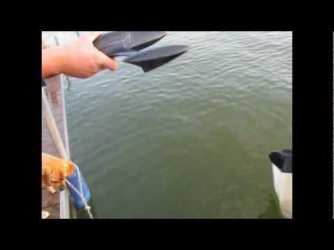

    Here ia my starhip! I bought a CF shell, and got all the rest of the hardware from Jim, over at MiniCatRacing.
    Stats:
    - carbon fiber shell, reinforced.
    - 3600 hobbywing KV motor
    - 60A hobbywing ESC
    - 3S Lipo battery
    - Y531 prop
    Sorry about the bad vid. I just got her going.
    Later in the run the last prop shaft I had broke. It twisted it in half!
    The.098 flex cable is not a smoth of a curve in it as I would like.
    Did I set it up wrong, or do I need an shaft upgrade? This is the 3rd shaft on this boat I broke.

            Did you notice you had your prop on backwards????
              • 9438
              See picture... Did you run it this way???
              Prop is backwards...

                Ray: Wow, never seen anything like that. On mine the driv dog is nearly against the strut, not backwards.
