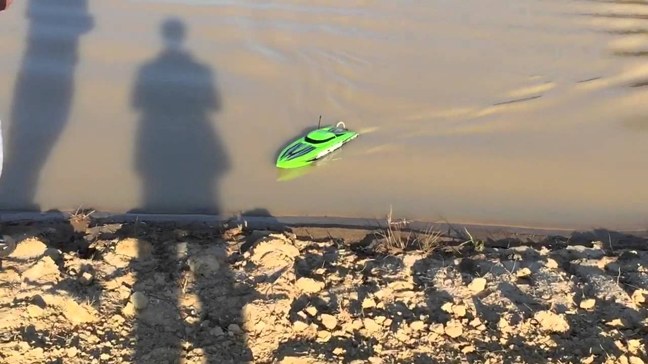

                      Good luck trying to get 50 on 3s comfortably. You'll find it's going to heat stuff up. I'm running 4s and going 54mph using a 2400 kv motor. You'll probably need about a 3500ish kv motor to get close on 3s but it's gonna be hard on the Esc. You got torque roll on a 42mm prop? I've run a x642, x443 and an x645 on it with no torque roll.
                      I think this is one of my last videos. Haven't run it lately.

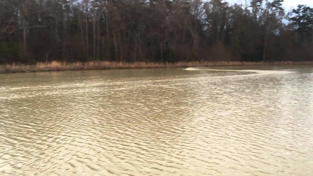

                        Another

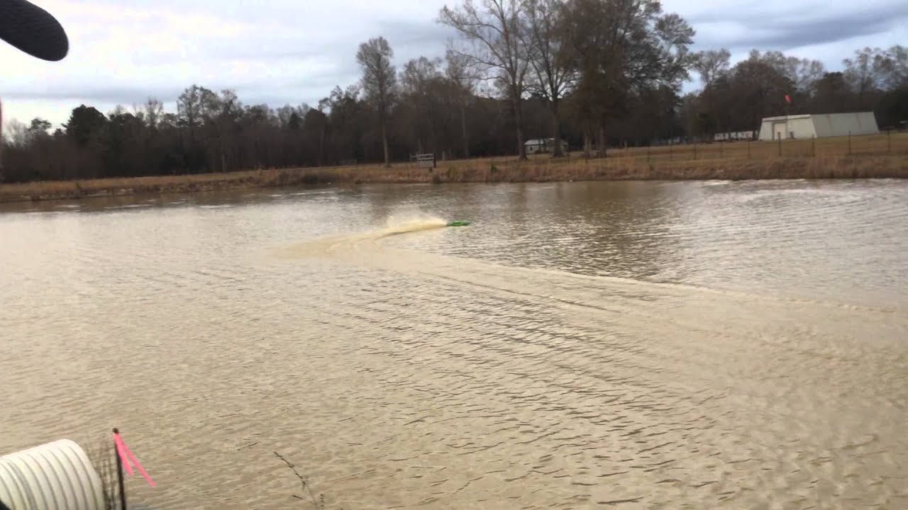

                          And one more

                            Nice job man !

                              Hey Trav, that video still impresses me! Just awesome work on your part. I've got a couple of questions. First how did you stabilize the rudder? 2nd Did you have to add any weight to it and where. I did a short test run on mine with the 3300 kv and 11.1 w/642 prop and tried to reset tabs lower but it still wanted to lift too much. I'm still trying to learn how to set up a sw26 for high speed. If I can get a good handling reliable boat at this point it would do. then I can check any heating issues ,if any. Any help would be greatly appreciated Thanks, Tim

                                Stabilize the rudder? I didn't do anything to the rudder. I might have added a little weight to it but not purposely. I added epoxy around the big tray that locates everything. I haven't had a lift problem. That 642 prop may be your issue. That's a lot of pitch and mine didn't like that same prop. I've tried a bunch of different props and mine like a 443 cnc prop the most. Hope that helps.
