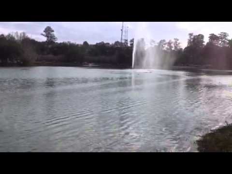

          I have a short vid taken with a phone cam.

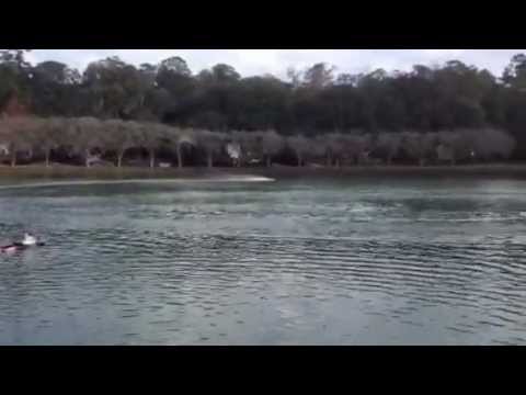

            Travis thanks for posting the vids.
            These two vids are not the best representation of this boat as I never really got into it like I usually do and therefore the speeds I was talking about just aren't there. This was the first run on the boat after a collision with a rather large turtle the week before, that broke the rudder and bent the turn fin pretty badly. Hopefully I can get a better video next weekend. I need to get a lifter prop for the boat and it would probably run a good bit better, I've just been running a cnc 443 prop which is not ideal for a hydro. I'm open to suggestions.
