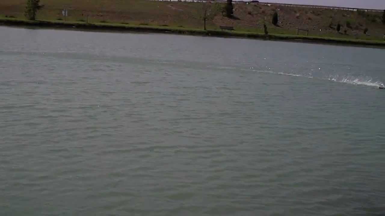

                My maiden run resulted in the flex slipping inside the collet. Also the battery was to small.
                So I came back to the pond with a Sky Lipo 4000 40C 3S. I also put some solder on the flex shaft.
                Back in the water and slipped again. Tightened it up and still slip.. WTH?
                Bring it in. Discovered that its not at the collet this time. My Loctite glue of the flex to shaft let go.
                So now I gotta pull it apart and solder it in. Glad I got a torch now!
