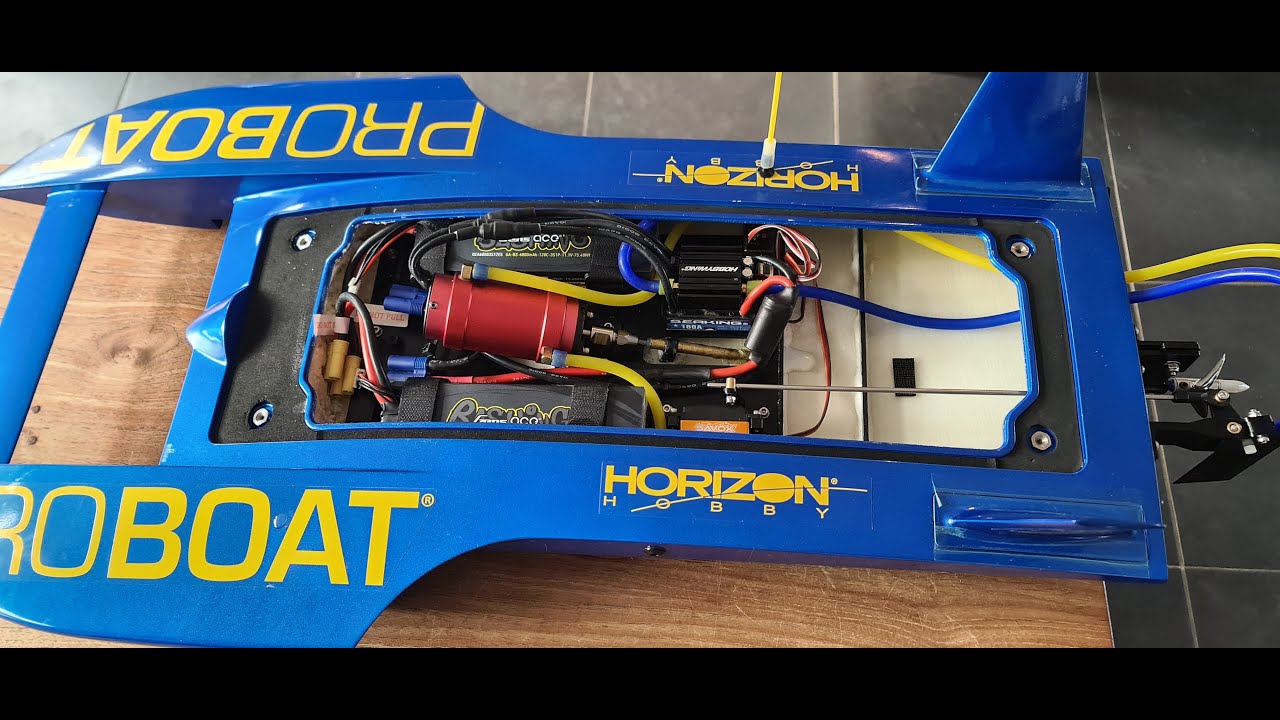

                      heres a couple UL-19's with 4092's
