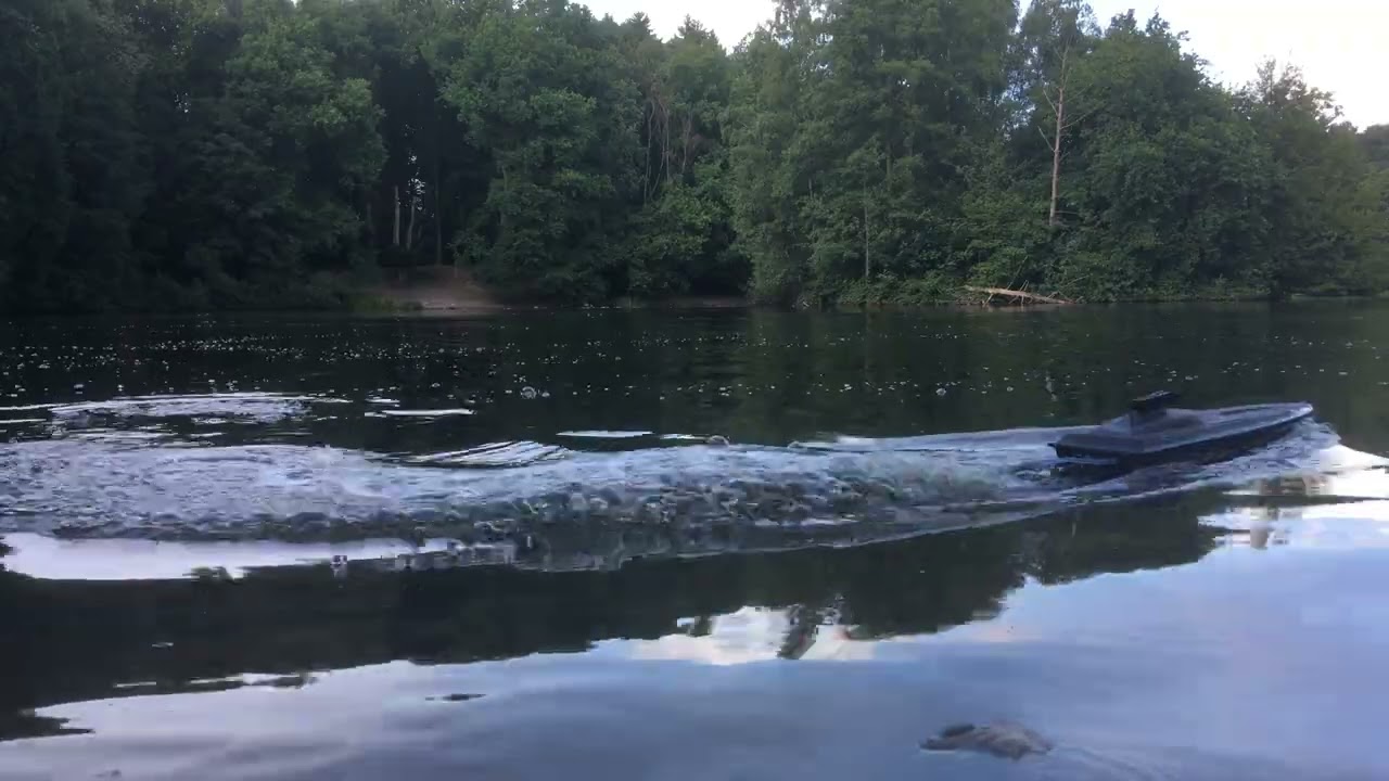

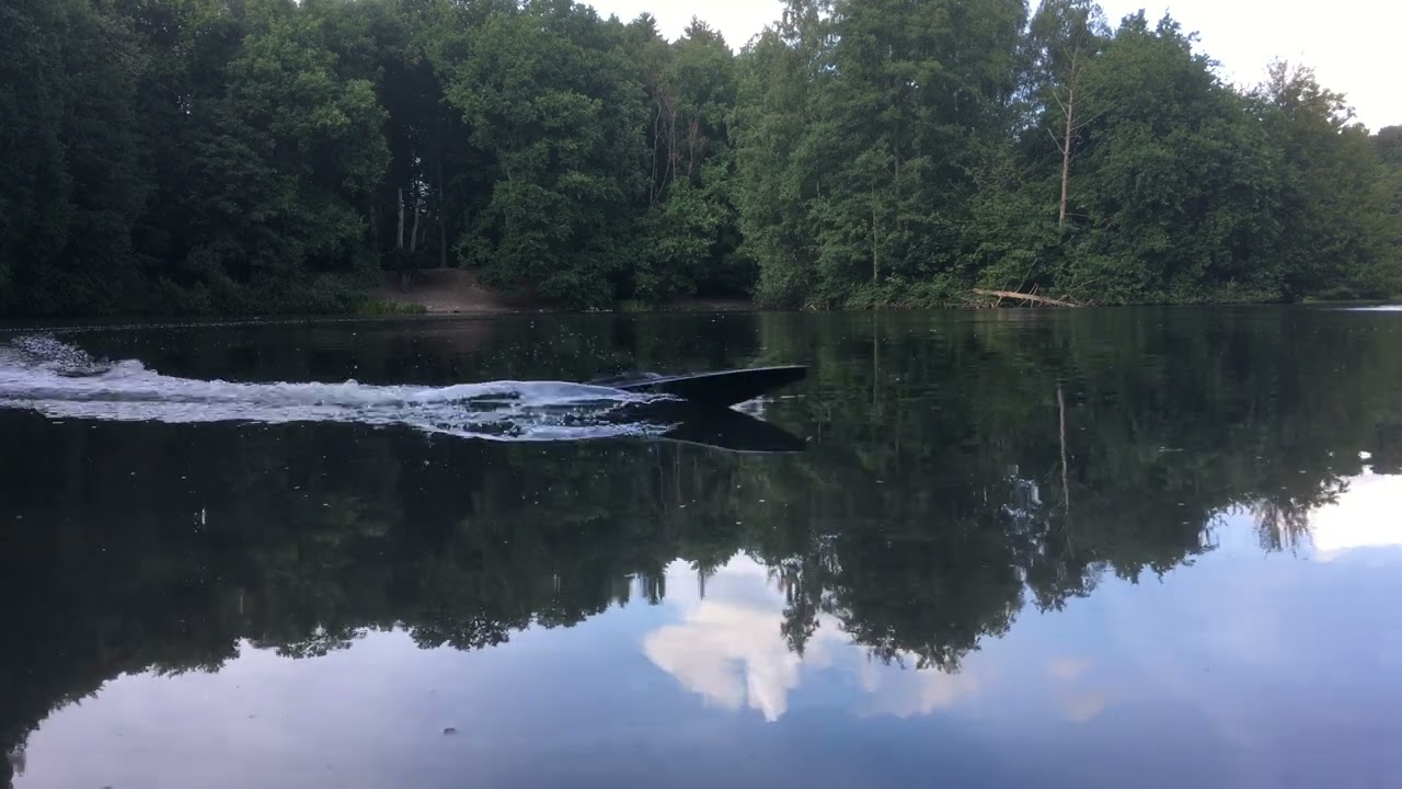

                      Here are the videos from todays tryout:

                            wow, I love that YouTube clip. You set the shooting position very well. Its speed is too fast.
