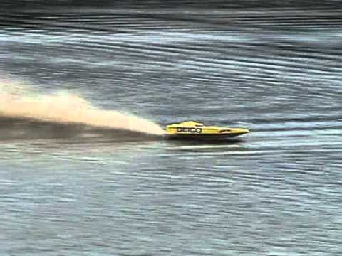

            Yes,
            The same buddy is running a good $30.00 HK 1400KV in this geico on 6s and loves it.
            http://www.hobbyking.com/hobbyking/s..._Inrunner.html
            Zoom zoom.
