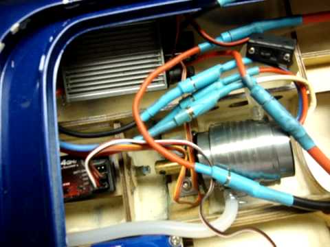

    Can someone tell me if it's motor or esc???
    So I was running my stock Impulse 31 this past Monday and I was on my second set of packs towards the end of the run and it just cut off. It took a few miutes to get it in so I didn't get any temp readings and my wife said she saw a little smoke when I pulled the lid but I didn't.She probably did because she has no reason to even think there would be smoke but if there was it was very little. The packs are fine. I was running 2-2s1p 5000mah with the stock 60 amp esc and 1800kv motor. I don't have a video of the run but I do have this clip showing what the motor is doing. Servo works fine but when I WOT this is what I get....
    Any help would be greatly appreciated so I can get back on the water!

      looks to me like one of the motor wires burned up inside the ESC. That happened to one of the guys at our lake. Proboat replaced it under warranty.
        One or more of the motor/esc connections is de-soldered. Like above stated too.
        May I suggest you add some more heat shrink to youe motor esc connector since they look like they could easily short out which may have been the cause all along.

          Hello If you have another esc you could try it. This is how the motor will sound if you unplug one of the three wires from the esc to the motor. I have seen the esc loose one leg of the three but normally it is a motor issue. Only way to tell is to try another esc or another motor. Good luck.
            You could also have poor solder connections at the bullets. They look like they are not stock bullets...I would check the solder on those first.

              Ok! Thanx guys,I will check this week and see what is up.

                Funny I just had the same thing happen to me Sat. Turned out to be the red plug on my motor came unsoddered from the 5.5 bullet connector I put in.
