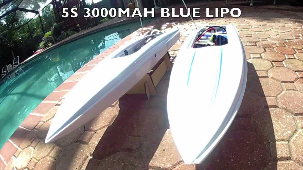

          I don't know that there is a magic formula to pick the perfect brushless set up. There are multiple variables. I usually go a little over board and put a little bigger system in the boat, that gets me speed, a little extra weight (in this hull isn't a bad thing), and gives me luke warm temps when done running. I have two impulses right now, well two impulses in my family that is, one is my dads and one is the wifeys, both of which I have upgraded to brushless.
          I happened to have most the stuff lying around to put in them. One has the pro boat 1500kv motor out of the Miss Geico and a turnigy 120a esc that we run on 5s and it is sick! The other has a 1300kv Tacon in it with the 60amp pro-boat esc in it and we run it on 4s and its a nice improvement over stock, once my dad gets used to it I will get a 120s esc in there to make the jump to 5s. I think anything in the 1300-1800kv range with a 120a esc on 5s makes this boat a blast.
          The only downside is while testing the wifes set up out last weekend In rougher water I got air had a hard landing and cracked the plastic hull. So now I'm working on laying some carbon fiber in it to reinforce it.
          Here's some vids of the Impulses in testing....
          Heres one on 4s
          This one shows the wifes stock impulse vs my dads with the tacon in it on 5s.
