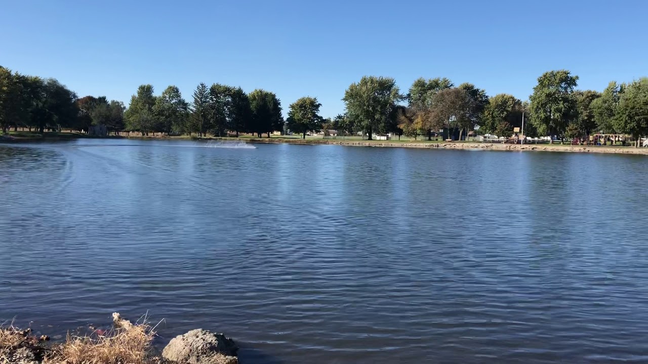

      I took her out today for to run though a coupl set of batteries.
      First laps it was nice and smooth, seemed a lot quieter too with a non-bent shaft. I had the stock prop on there.

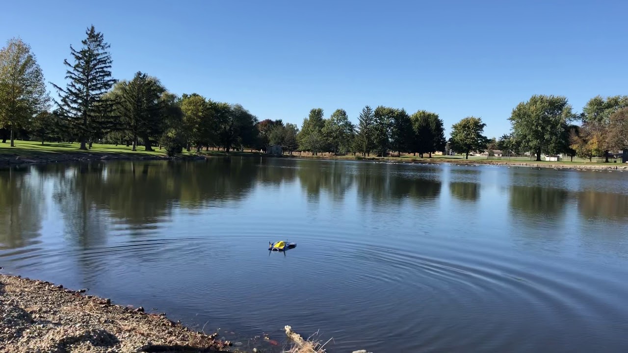

        I. Swapped out the batteries, made sure the coupler was still tight and swapped the prop to the pre-prepped Octura x442.
        EVERYBODY stand up and scream “I TOLD YOU SO!!!!”
        Disregard all the measuring and verifying the numbers bs...it doesn’t matter. Apparently OSE ,150 shafts are not compatible with Proboat couplers regardless.
        My new prop and new shaft now rest on the bottom of the pond. I’m more pissed I just didn’t listen to you guys. But when the place selling the shafts says it will be fine, what do ya do?
        I can’t believe my wife isn’t upset about it and she can’t believe I’d share my mistake with the people that warned me.
        Lesson learned the hard way, I’ll admit it when I’m wrong especially when the proof is undeniable.

            I could try to drag the pond with a big magnet since my vid footage shows where I lost it. But it’s pretty deep and no “people” boats or swimming allowed, and who knows how much crud and sludge is on the bottom So tossing a magnet out that far and dragging it back in could be futile.
