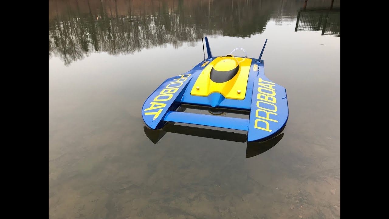

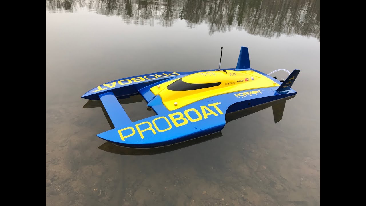

        UL-19 HITS 63.5mph 100% all stock
        Here is my 100% stock boat run on 6s. Not my best battery packs by no means. My best ones along with my best hardware will go on the boat after I get the upgraded flex installed. All I got was 63.5mph on this run before the rain came. Thanks to Chris for the s&b on the stock prop as always!

          Below is my 4s run.

            Looks like you are getting that new boat sorted out. I am surprised at how badly that boat submerges under light acceleration.

              Thanks VInny! It does decent and I don't think I'm to far off on my speed guess of low to mid 70's after it's equipped with my "good stuff". Yes, as you noticed this boat is nose heavy and can go scuba diving if you take off very slow with it Lol! I've searched around online for a benchmark and the best speed I've found with this boat is like 68mph running an ABC prop. With that being said I guess a bone stock run of 63.5mph isn't too bad. So just maybe I can get the Blue boat in the 70+ mph club as well....

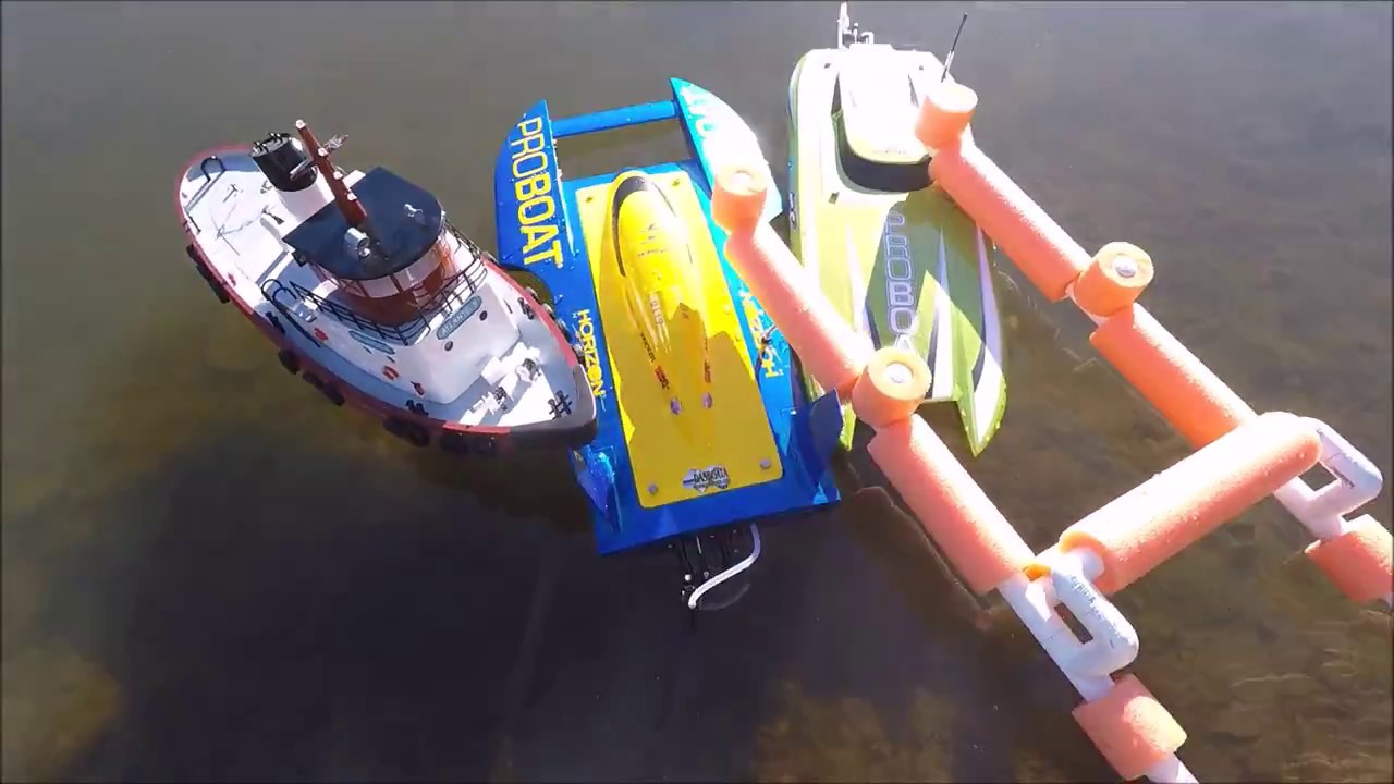

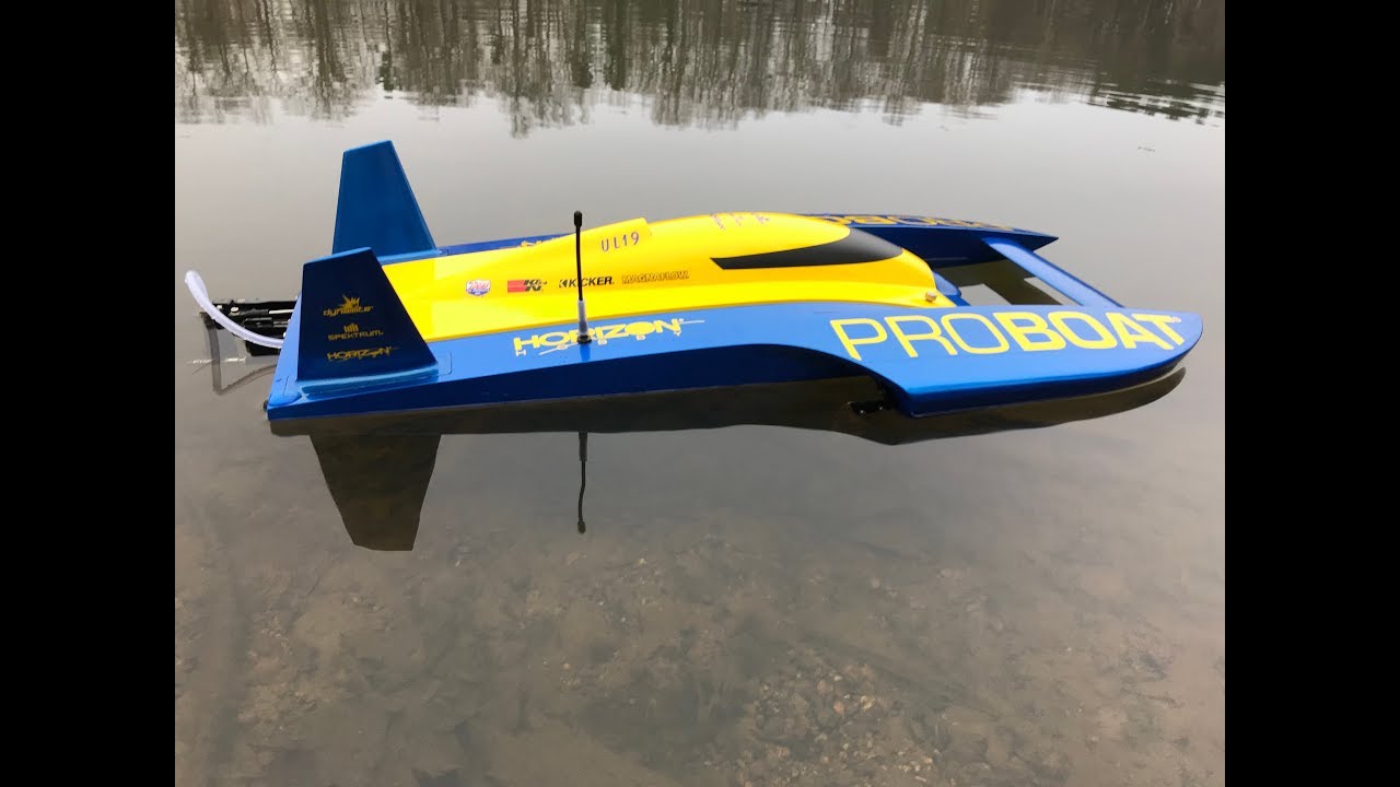

                        My Quest for 70+ has begun
                        I figured that I would share my 68mph run with you all from a few days ago... so here it is if anyone's interested (it didn't end without a rescue though). The boat was still set up fairly wet and conservative (still feeling it out) and I made three pretty decent passes, then I was waiting on the water to calm down for a couple of more passes and as I was taking off the flex came loose from the collet (should have changed it out from the start with) and it was dead in the water. So the risk taker that I am and I was being lazy and didn't want to get the Tug out of the car for the rescue, so I tried to rescue it the Veles and it didn't go very well as you will see from the video. The boat got 67 and 68mph on the GPS and the data logger. I was able to later retrieve my flex and prop since I was able to see when it fell out during the retrieval process. The flex looks like it could be reused but I'm not risking it anymore. Now I'm now ready for calmer weather with my upgraded shaft to give it a go again. Thanks again to Chris for the Awesome prop work!
