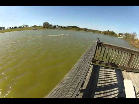

    well took it out to try it out and i must say i really like this boat handles good seems fast i had 30mph winds yesterday so i was just feeling the boat out mostly didnt get to crazy with it i had already flipped my revolt earlier her is a vid i made driving and filming at same time you can hear that wind blowing set up is seaking 120 tacon 3674 1900kv 2 pole motor with a m445 prop and 4s still got low 40's and could not open it up
