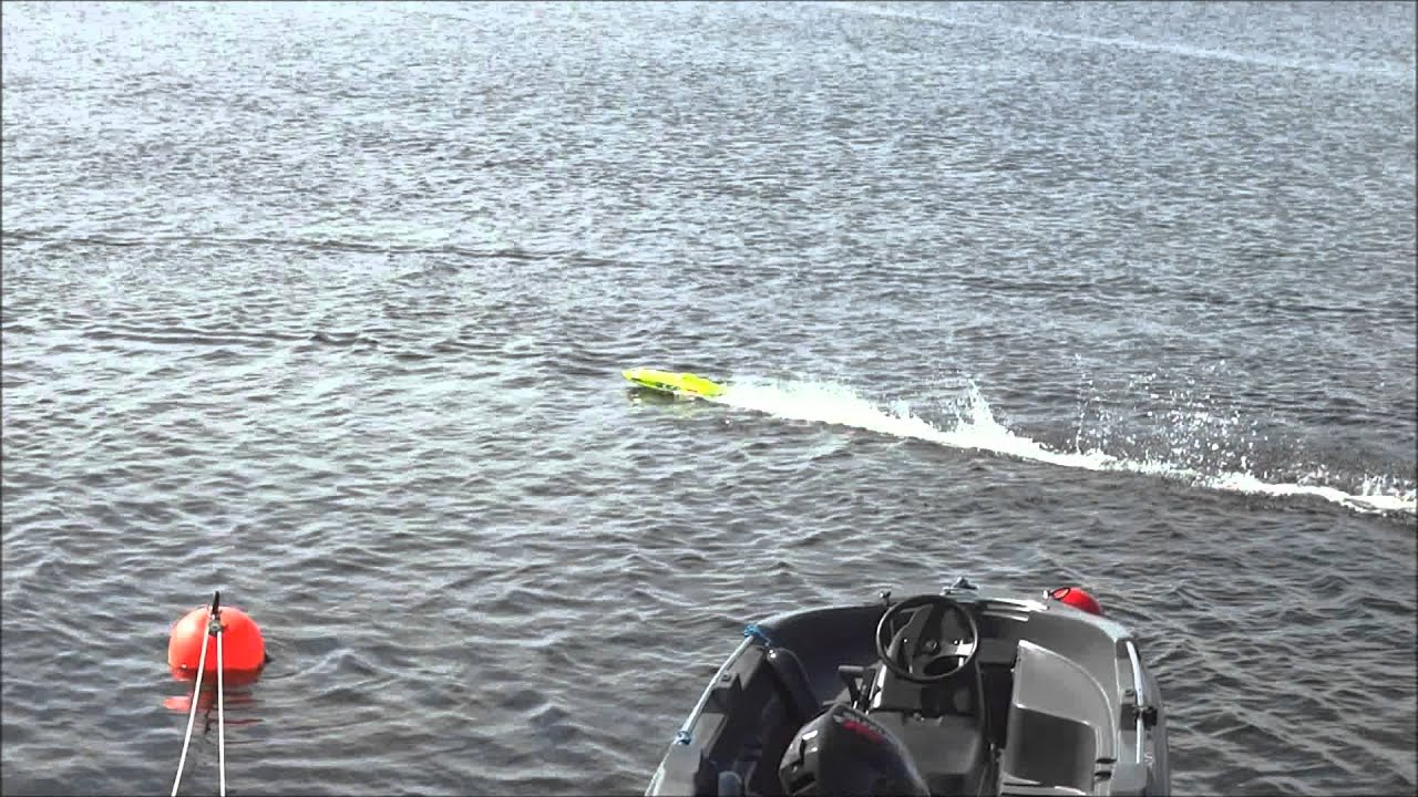

Miss Geico as submarine and aircraft
Second time did not go so well, almost the same place to.
The best I could do since it was first time with glassfiber. Messy stuff. Nobody will se at wot out in the lake anyway..Drammen rock City
If you can get inside the hull it's best to do it from there. And also lay some fiberglass cloth within the resin to add more strength and get all the air bubbles out. Just laying resin over the crack outside won't hold it long in an accident.
There are other methods that work too. This is the only one I've done so far.Land, Sea & Air, A true RC Addict.
I know. I used slow curing (24h ore so) epoxy the first day, then I mixed up for some glassf. But it was the autoshop type with to big masks and a hassel to work with on the tight spot. It passed the water test, no leak :-)Drammen rock City
