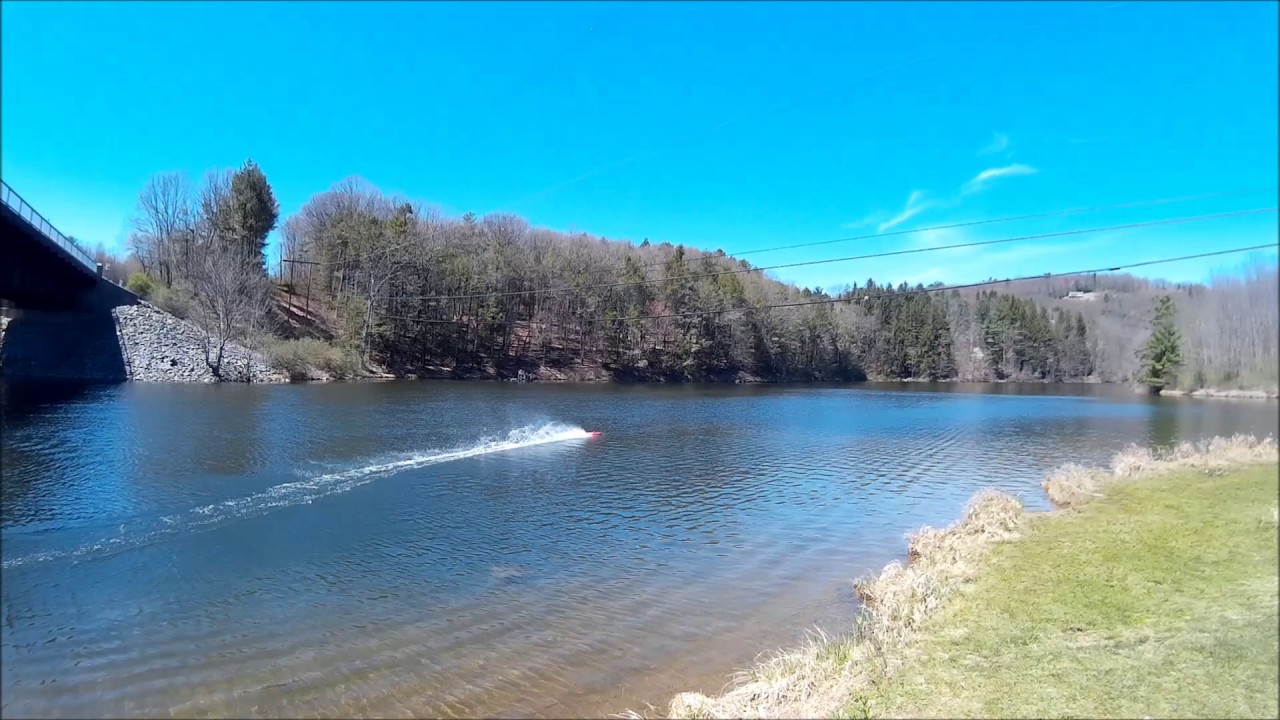

    should i raise the strut? can you tell by my running video if its running too wet?

    Raise strut to 1/8" above the table ( I run mine at a slight negative angle ). One prop blade should be in the water when at speed.
