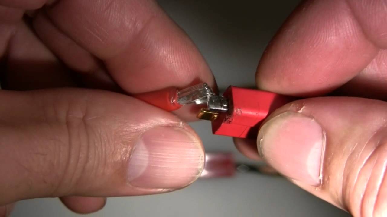

              Here is a great video regarding the weakness of using Deans plugs. Not so much the plug itself but the solder joint. Unless every factory Deans solder is PERFECT, the chances of desoldering the wire during repeated high current applications is very real.
              That being said, in this video the Deans solder joint only failed at 300amps+ ...think about that for a moment... how many Li-Po's, ESC and brushless motors can tolerate 300amps+ CONTINUOUS???? The silicon insulation and plastic housings will all melt off first before the actual plug failure!
              However we know EC5 plugs to have greater plug to plug surface area for electrical contact than Deans, thus the higher current rating of EC5 plugs compared to Deans and my preference of using EC5 connectors for my RC applications.
              For the impatient: skip to 0:30 for the Deans test and 2:28 for the damage assessment.
                • 9438
                Deans solder joint lasted only 3 sec. under 300 amp load. That's a short run time.
