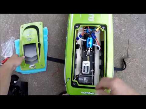

                        #281
                        Originally posted by Brushman View Post
                        Nice you did 69 with a prepped stock prop, but I did 74...
                        Below is the full uncut video of my 100% ALL stock run prop and all verified with proof...Where can we find your 74mph run using the stock prop? BTW It looks like your 55mph speed on 4s is a little off the pace as well, I ran 57 mph on 4s...You can find that video the same place you found my other runs if you want to see it, and of course it has the proof with it as well. I'll be looking forward to your video of your updated run next weekend! Remember to have your friend get the gps cleared out on video before the run and lets see it as soon as you pull it from the water.
                        57mph (92kmh)4s run https://www.youtube.com/watch?v=B9PPfggFmsw
