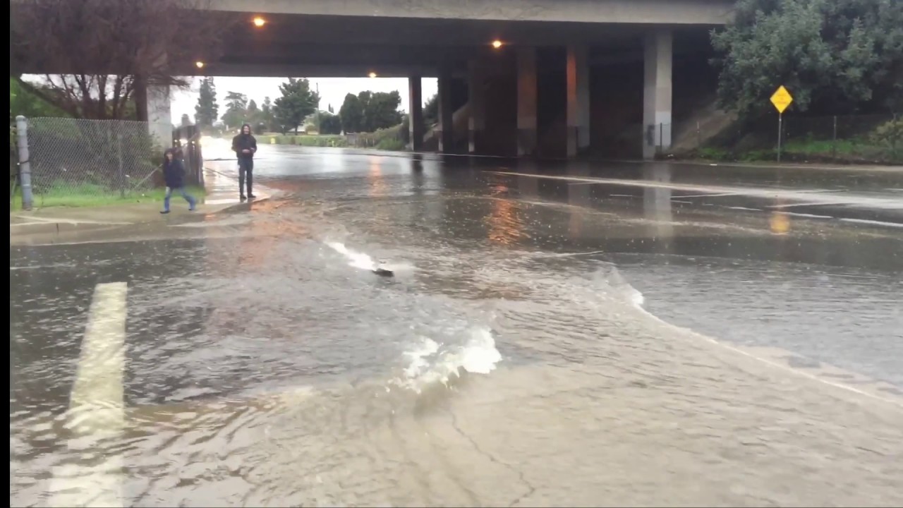

                    Hey Guys, sorry I'd not been in this section for a while. I've been busy running jet boats in the street.
                    The boat indeed runs on 4s. I run 3200 Eflite 4s packs. On 4s, because of the self fight feature and the rotating mass of the outrunner coupled with the weighted motor coupler the boat will pull to one side a bit in open water. In that latest video, I ran the boat on 3s and was at around 1/2 throttle the entire time and would only hit full throttle to swing the transom around. My boat doesn't self right anymore. I swapped my weighted coupler with a straight 5mm/4mm coupler from OSE. Don't get me wrong, the self right feature is great, but during all my testing I can count on 1 hand the times I actually flipped the boat and needed to self right it. I can say the same thing about the Recoil 26. Everything is so low in the hull that it's really hard to flip it over under normal circumstances. So why make it self righting? Because that feature alone sells boats to people who are put off by not having a way to retrieve them if they flip. I'm sure the day will come when I flip it and wish I had never pulled the coupler out.
                      Man I need to get me one of them "street" boats! Lol
                        Guess I should have added "flooded" to my street comment.
                          Nah I know! I've been watching your vids you post. That boat turned out great btw, very impressed with the looks of it.
