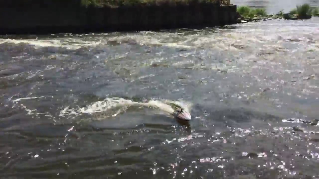

                            Very good feeling on this slalom course.

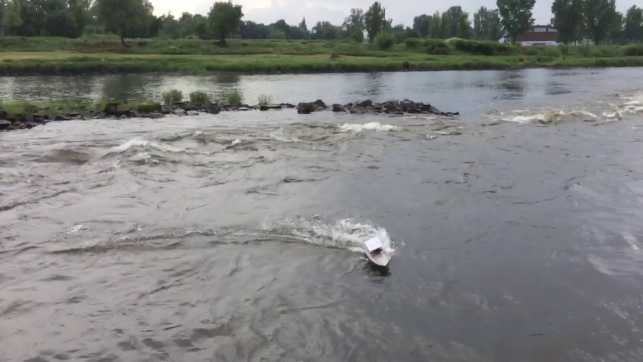

                              Today second try on canoe slalom course.
                              Made foam roof for quicker self righting as you don’t have time for classic one in such wild water.
                              Steering nozzle trim is now full up and its much better on big waves. It can jump now well :)
