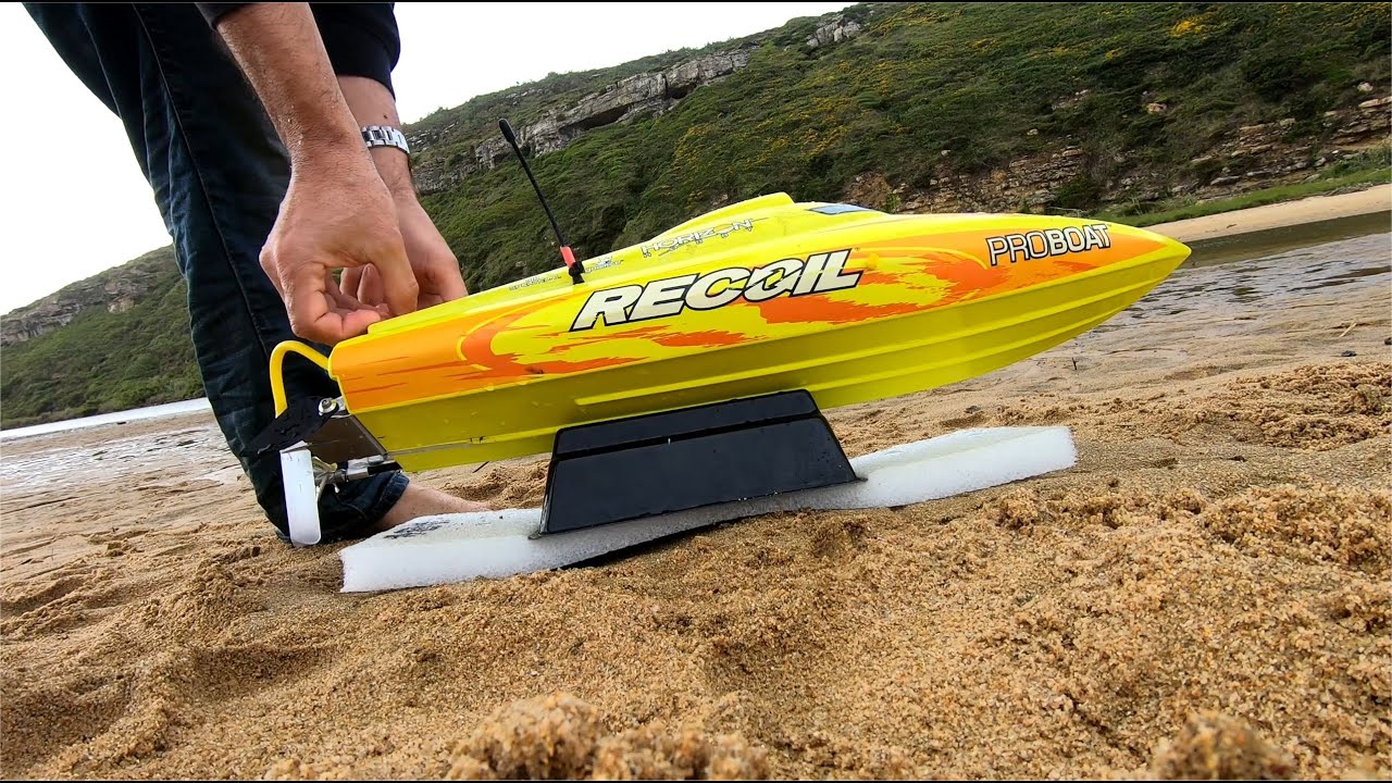

                              #44
                              I have no temperatures issues even with a Prather 230s prop! But it ain't stock, just the hull...not even the canopy! Well still stock shaft! :P
                              -Take a peak under the hood...

                                All show, all go...
