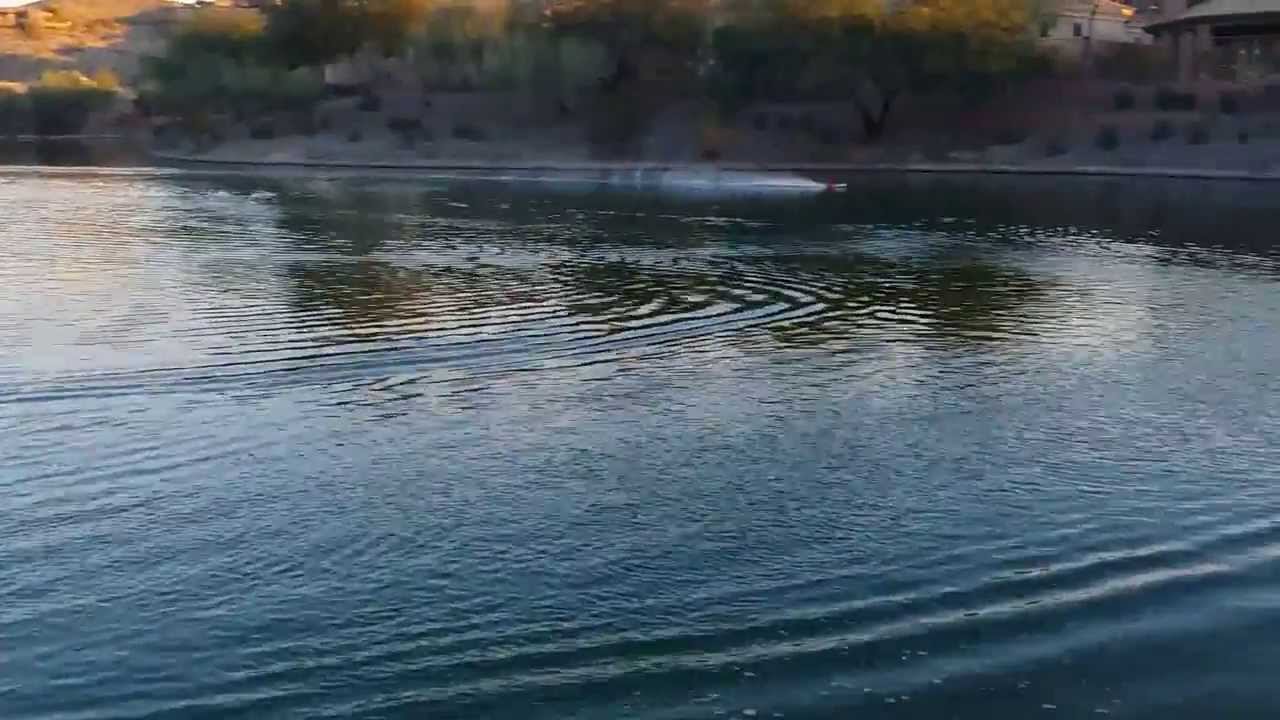

Nothing stock about that BJ29. OSE upgrade Leopard motor and T180 ESC on 6S with Octura prop. Stock driveline parts, though. About 45mph I think... She turns on a dime!
