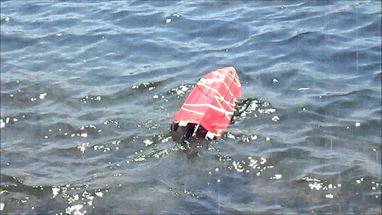

    I've had a spare SV27 hull I paid $30 for kicking around for about 3 years now and had been meaning to finish it for all that time. I finally got around to touching it up, painting it like my other (the original was just striped up with Mono Kote trim) cutting a big hole in it and putting in a flood chamber made of some thin sheets of fibreglass.
    I took it out today for its first run (with just the stock blue SV motor this time out). Here is the result:
    This was with a couple pretty lightweight 3200 mah packs. It needs a little help (a bit of torque from gunning the motor does the trick) but other than that, it worked great (it already has a bit of extra weight on the left side, so I don't really want to add more). With heavier 5000mah packs, it may even work better.
    Now I can get completely juvenile with it and leave the fishing rod and tennis ball in the car!

    sounds okay... Does it handle alright with the extra weight on one side?

      How about some pictures of what you did?

            dood nice work! the supervee must be so much fun without having to worry bout flipping
                Yeah I know, I've always liked the Supervee but the upside down time was really putting a damper on the fun. I just need to make sure anything that can fly loose when you stuff the hull (like battery packs) are very secure before going out.
                I'll post some photos later tonight, for now, I think I'll take it out for some fun.
