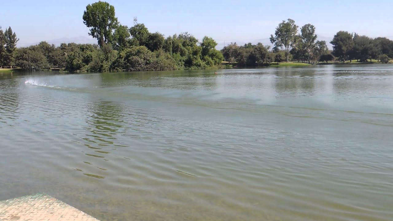

              Some updates: this run today I had on with a X642 prop, this is a faster prop (compared to the Grim 40x52/3) , also liked the X440/3 a lot. I tried the Grim L42x66, while I liked the speed, the lifting characteristics introduces new issues that need to be dealt with. So I stayed with non-lifting props.
              I will not run my UL-1 without the Air-Foil, this much I can tell you.
              The untold story here is that after the new pads were installed, the ride got much worse---I kind of expected that as the clean articulation on the pads exaggerates the inherent problem with the mushy lines of the FG hull. The port side is always jumping out of the water and this motion will amplify as the run continues at WOT until a barrel role is commenced. After careful reshaping and lessening the AOA on the port side, the ride is better and calmer, and the video shows the improvement. I raised the strut a bit because the Air-Foil is doing its job. I did not post this in the Product Review Section since this is my observation and is not solicitated from the maker of the Air-Foil.

                          From here, 48mph and stable looks Great! Especially when you consider it's starting point.

                              looks like she runs beautifully smooth and flat. I have a couple questions, first is about the GPS you are using, I have been trying to source one out so I can compare what each mod does but have not been able to find one. would you happen to know where I could find one ? second question is which air foil are you using? the air dam that goes between the sponsons under the boat or the one that gets taped on the front between the sponsons? thanks John
