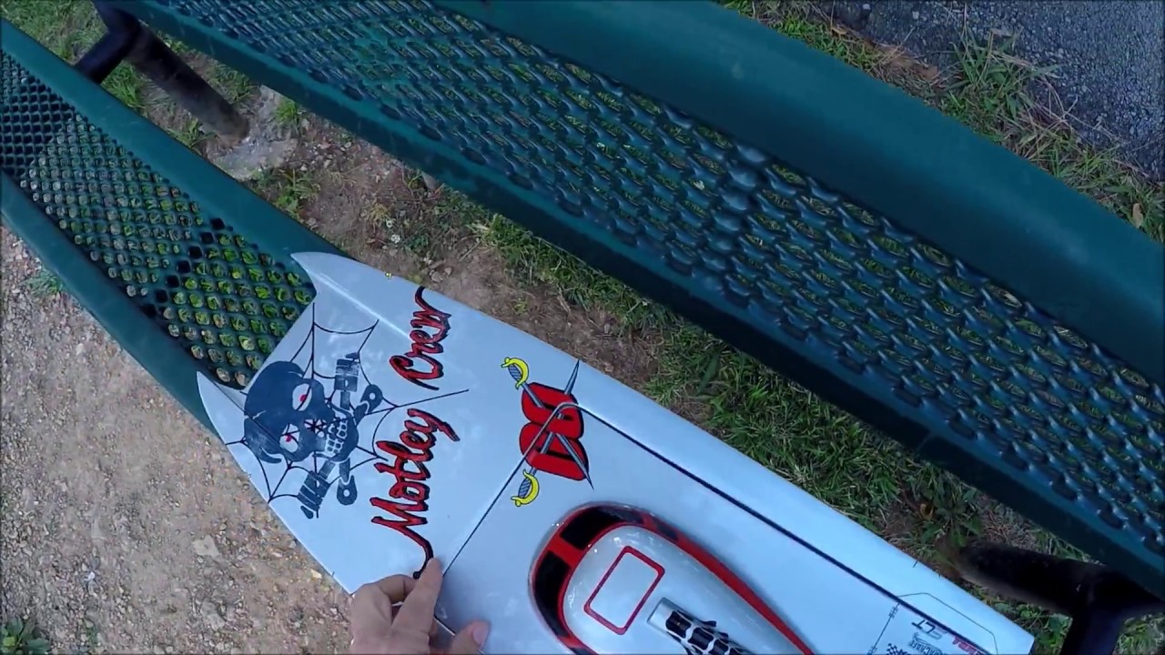

                    Ran the boat yesterday with a 2030kv in it while I am waiting on my replacement 1800kv and hit 45.1 mph with a x442 mild s&b. Am I in the ball park with this prop and set up? I didn't try to re adjust strut and try the x642 again during this outing but it still looked like it was flat and a little too wet. Probably could raise the strut a mm or so and pick up a little. What y'all think? If I am getting 45 with the ESC I assume it is ok?? What ya'll think? The strut is flat and touching the table when the rear sponsors are pushed down while touching the table. See video

                      #40
                      That's about right with a 442, looking pretty good actually.
                      I would leave your hull settings the same, especially if you plan on using the X642 prop, the temps and consumption won't be that much higher.
                      But the danger with the X642 is that it will bump you up to 50-54 mph range immediately on the 2030kv motor. Which will increase that hull flipping over more easily, which could damage that stock hull at that speed.
                      To prevent that, running a little more wet and/or also moving your batteries farther forward is a good idea. A forward portion of my batteries are slightly past the motor mount on my boat. I also run the front air deflector to further risk the chance of blowover.
                      Unlike other hulls, these Aquacraft tubs are not as easy to reinforce. My stock hull cracked almost from tip to tail after a 54 mph flip. I fixed it from the outside and it seems to have withstood several more bad flips, but the Lucas oil hull doesn't seem to be as strong as the stock Motley Crew hulls, even though the designs are the same.
                      Just be careful going forwards, try to avoid the hard flip on a stock hull.
