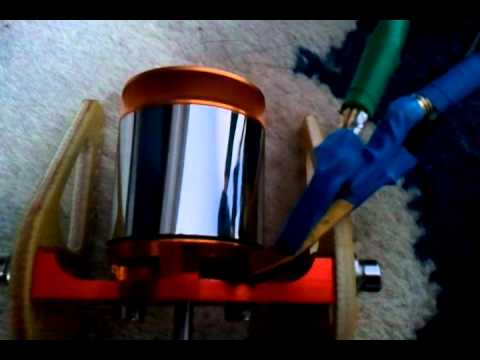

Out runner? Not sure what that is unless spellcheck got you on the word rudder?
Thanks for your help
Thanks for the explanation , I have all stock hardware. Just wanted to make sure I don't overheat my stuff with trying bigger props. Thanks for the video
